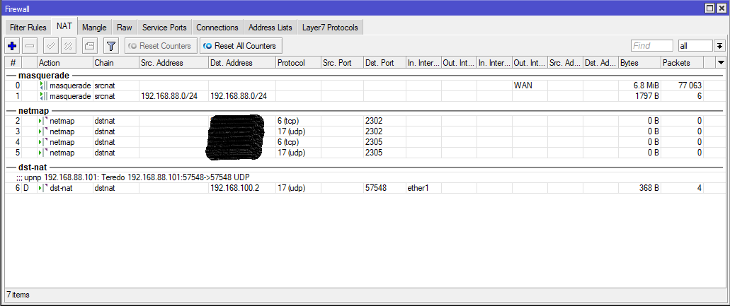

  • All counters just zeros. No packets, no bytes. But the new masquerade rule still captured a couple of packets, but not when I ping the port from the outside.
I know the difference, I’m just trying to set it up as accurately as possible so that it works at least to begin with. Therefore, I will do the optimization.
Thank you, it became clearer.
Thx, already read it, but still not understand what i do wrong.
But judging by the screenshot and the rule added by UPnP, you don’t have STATIC_IP directly on router (in IP->Addresses), right? If not and you actually have just NAT 1:1, dstnat rules with dst-address=STATIC_IP won’t work for connections from internet. You can use dst-address=192.168.100.2 and see it that helps. Or in-interface=ether1, if you tried that before, should have worked too.
Before I started changing the NAT settings, my rules were configured for the interface ether1.
And yes, most surprisingly, the UPnP rules work, and registered packets and bytes.

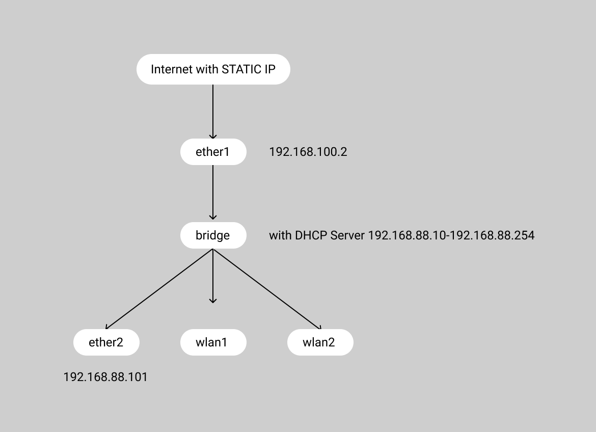

I will describe my network as it actually is.
