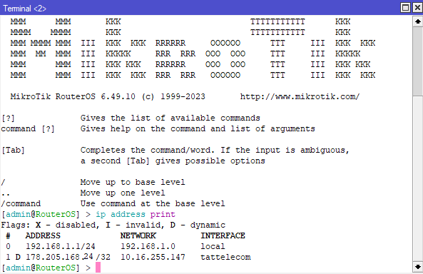

Hi Frends! The router connects to the Internet via pppoe.
I’m doing port forwarding to a machine with open RDP. But it doesn’t work
Copying the sanitized output of the “/export” command into a “code” block is far more useful than screenshots. These in particular do not show whether you gave the key “to-port” parameter.
