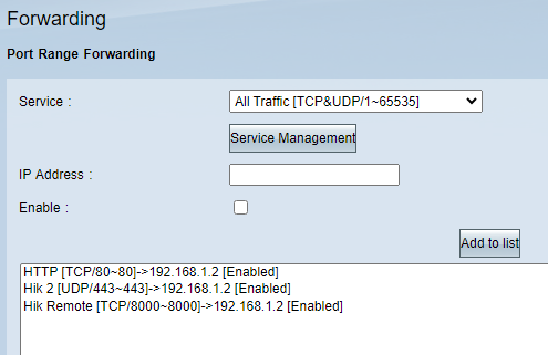

Up till now, I was using a Cisco RV042G router, with three simple Forwarding rules, and everything was working perfectly (see attached picture).

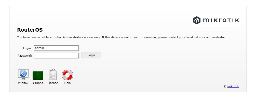

I have tried different NAT rules, from some tutorials on youtube/internet, but each time I try to login remotely from hik-connect portal, I get my Mikrotik admin page (see attached printscreen too).
