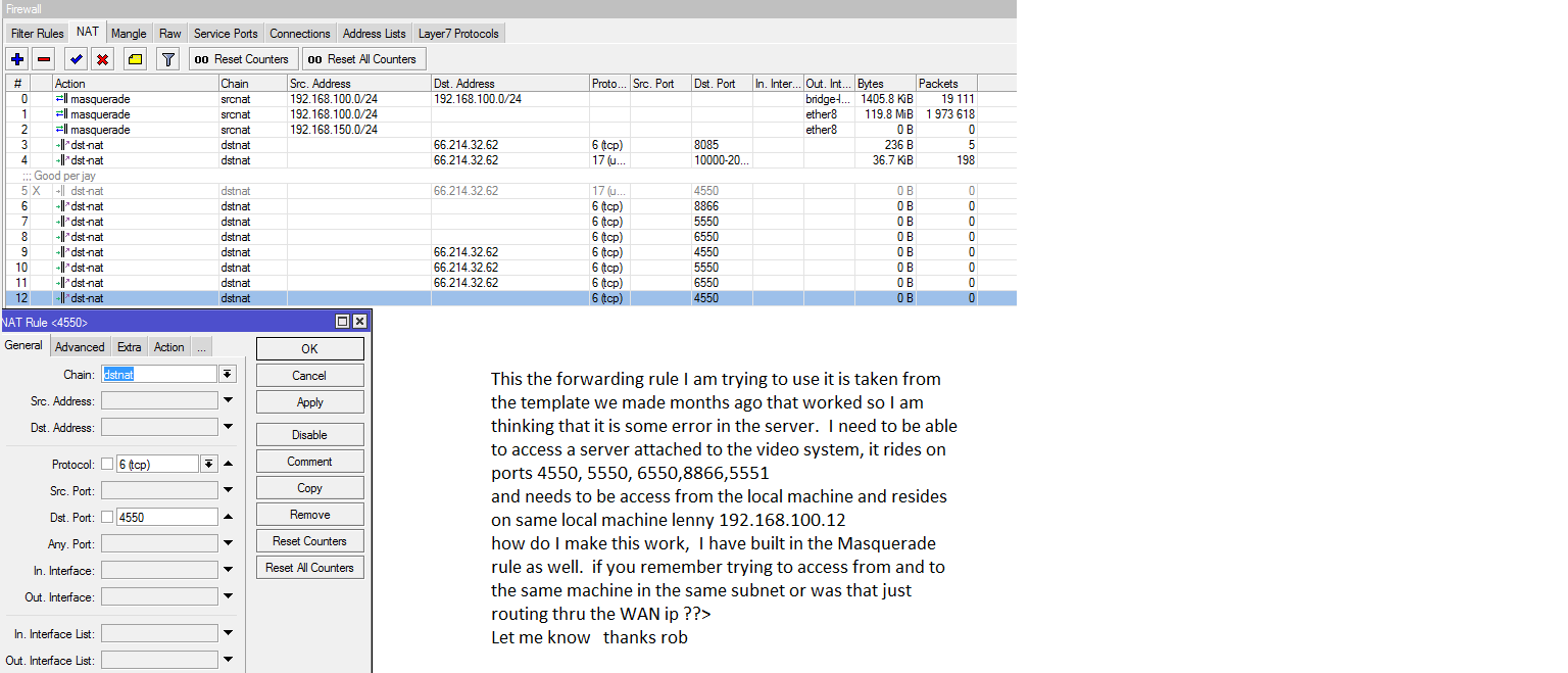

I am the IT here at my office and I got tossed into this Mikrotik CCR1009 router I love it because I have the ability of full control however I am not brushed up on the scripting and port forwarding is the
big thing with most routers. I would like to port forward scripting for the following
  1. Internal IP to Internal IP from the same machine in other words I am on machine ip 192.168.100.12 and the server is running on the same IP and machine, I need to forward the following ports
    a. 4550
    b. 5550
    c. 6550
    d. 5551
    e. 8866
Here is the scripts I have tried
add chain=dstnat dst-address=66.214.32.62 protocol=tcp dst-port=4550 \ action=dst-nat to-address=192.168.100.12
add chain=srcnat out-interface=WAN action=masquerade
The Script loads and saves without errors however it does not let me access the server at port 4550 on ip 192.168.100.12
any ideas
thank you
Rob

I have a server sitting on IP 192.168.100.12 and using several ports> 4550 5550,6550 5551 8866
and the machine I am using to access said server is the same machine that the server is running on
192.168./100.12
see this attachment for the details it explains it better ignore Jay he is my regular tech that happens to be on vacaion rite now
Thank you for anything you can assist with
Rob

But to make the Mikrotik do what you want, you need to setup hairpin NAT.
There are many, many threads on here about hairpin NAT, so feel free to google up some links and see how that works.
In a nutshell, the Mikrotik needs to do srcnat (usually masquerade) on packets going out the LAN interface whose original source IP address is also part of the same network.

Using DNS:
Use hostname Mybox.example.com instead of the literal IP address 192.168.100.24 / 66.214.32.62
If you’re inside the network, and were to type “ping mybox.example.com” then you should ping 192.168.100.24
If you’re outside the network, then “ping mybox.example.com” would ping 66.214.32.62
Using Hairpin:
add chain=srcnat out-interface=LAN src-address=192.168.100.0/24 action=masquerade
Thank you very much
I do appreciate it I tried that and it worked
