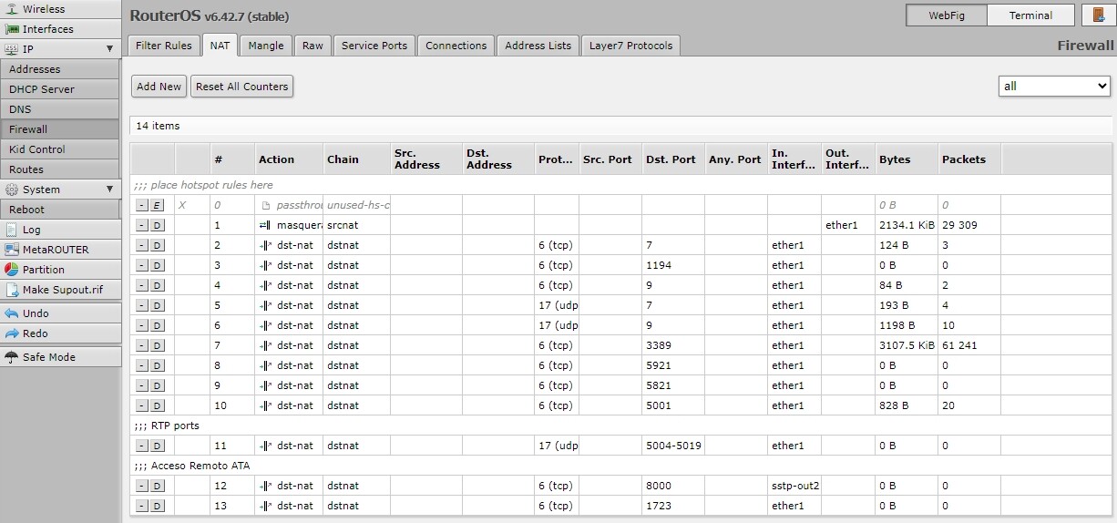

Is there some specific or special thing I should do to have this VPN access working? I have a limited administrator access to the Mikrotik, for instance I can access to IP-Firewall rules/definitions, but not the full administration rights.

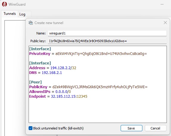

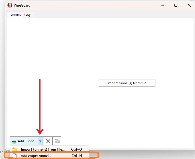

Step1: Download window installer from wireguard website.
Step2: At the popup window Select the arrow next to add Add Tunnel at the bottom.
SELECT: Add Empty Tunnel
Step3: Give the tunnel a name.
Step4: Note and copy the public KEY under the name. This will be used on the MIkrotik to identify this PC peer.
Step5: Then copy and paste the block underneath existing INTERFACE and PRIVATE KEY. Adjust the numbers to reflect your setup.
Remove the notes as they are there for your understanding.
[Interface]
Address = 194.128.2.2/32 { address you will give to the Windows Client. Lets assume address on router is 194.128.2.1/24. }
DNS = 192.168.2.1 { Use the gateway IP of the wireguard }
[Peer]
PublicKey = dZek49BWgVCLJRMsG6k6QK5mzHFrfy4uhOLjPyTe5WE= { this is the public key generated by the Mikrotik device }
AllowedIPs = 0.0.0.0/0
Endpoint = 32.185.112.15:12345 { public IP address and endpoint port of the mikrotik wireguard }
Note1: For allowed IPs, if the PC requires internet access at the MT device, enter 0.0.0.0/0 as shown. If you only want users to connect to the LAN subnets (for example 192.168.0.0/24) on the Mikrotik router then select the following:
AllowedIPs=194.128.2.0/24,192.168.0.0/24
Note2: Persistent keep alive is not usually used on PCs or Smartphones as its not a router to router connection that normally should be up ALL the time.
Step 6. SAVE
ENSURE The MIKROTIK Wireguard is setup, then:
Step 7. SELECT ACTIVATE BUTTON and wait for status to be ACTIVE.
DONE! No certificates, nothing tricky at all, just some cut and paste really.
It should be clear that its best to configure the WG on the Router first and copy the public key it provides so you can easily paste it into the windows install and vice versa copy the windows public key to install in the Mikrotik setup.

You see, this is one of the limitations my config userid in the router has. I was just looking for the FILES entry in order to do a backup before we changed any thing, and I couldn’t find it, same for your indication of looking for “new terminal”.
I am attaching you an example of the config screen I have access to. Hope this gives you an idea of what I am allowed to do in the router.
