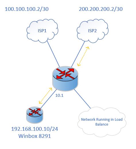

Thanks for the reply and sorry for the lack of info please see attached file of the diagram.
I’m running 2 ISP for load balancing and my LAN setup via VLAN connection, I have this certain network that would like to be forwarded specifically to the ISP2 so what I did is to force this network-winbox traffic to work only to ISP2 but after doing that I can’t ping the local gateway and make work the port forwarding..
I used mangle to force the network-winbox to run only via ISP2 and accesible to port 8080
btw here’s my configuration on forcing the network-winbox to ISP2..
add action=masquerade chain=srcnat comment=“ISP1” disabled=yes out-interface=“ether1” src-address=192.168.100.0/24
add action=masquerade chain=srcnat comment=“ISP2” out-interface=“ether2” src-address=192.168.100.0/24
add action=dst-nat chain=dstnat dst-port=8080 protocol=tcp to-addresses=192.168.100.10 to-ports=8291

Your explanation is again not sufficient.
I dont see vlans in your diagram and what does winbox have to do with it?
Just stated your managment vlan or subnet is X, could be the same as your home vlan/subnet.
Please post entire config
Winbox has no need to exit the router, that is a very dangerous and insecure approach.
Winbox should only be accessible from an external user (aka you) via a VPN tunnel and the tunnel is to the inside of the router and there you access winbox.
So in a nutshell you have X number of subnets or vlans,
You want one vlan/subnet to ONLY use WAN2
The rest of the vlans/subnets you want to access both WAN1 and WAN2 as equally as possible.
(what are the speeds of the two ISP connections?)
(are the connection to static or dynamic WANIPs?)
I agree with anav that what you’re asking isn’t abundantly clear. But I understood is as follows.
You have an internal subnet and you want to route to and from that network to ISP2.
If that’s the case, I think you’re way overthinking this. Just add mangle rules before those that do your load balancing scheme and set “connection mark=no-mark” in those, so that they don’t replace your network previous specific rules’ connection marks.
