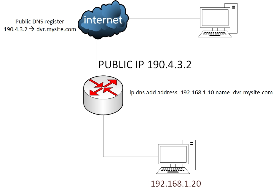

You could use dns rule (ip dns) like dvr.mysite.com pointing 192.168.1.10 and register the public IP with public adress, that’s a easy way to solve it.
I am not understanding it, Pl give me details
Here it is a picture with an explication
This system work for one dvr (because we have one public IP) but we have 7 dvr.
You means public DNS register, which we register from domain company.

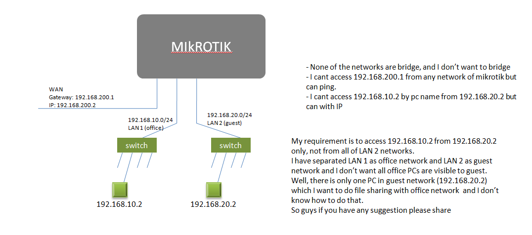

I have two different network:
WAN 1: Gateway 192.168.200.1, IP 192.168.200.2
LAN 2 : IP 192.168.10.0/24 (office network, and has server)
LAN 3: IP 192.168.20.0/24 (guest network)
There is no any bridge connection and I don’t want computers of LAN 2 to be visible to LAN 3
Server IP 192.168.10.2 (connected on LAN 2)
User IP 192.168.20.2 (connected on LAN 3)
I can ping server from User pc and also I can access server files by \192.168.10.2 but I cant access by \ServerPcName
All I want is to access 192.168.10.2 from 192.168.20.2 only, not from all computers of LAN 3.
Access to \servername from different network requires some setup on the windows sharing level and doesn’t have much to do with router’s firewall. You’ll have to learn about windows domans and how to span multiple broadcast domains.
