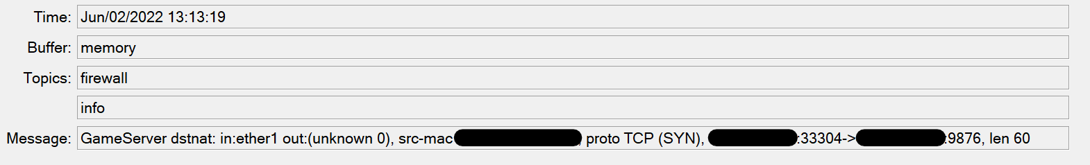

I’ve attempted several ways to port forward, and I’ve come up unsuccessful. Using quickset port mapping or manually adding had no effect. I’ve tried adding port firewall rules and disabling windows firewall, to see if that was the issue. When attempting the connection, I am getting packets received on the NAT rule. Firewall connections, does not show any active on the desired port on the local PC. Logging shows attempts to connect on port from outside.

Probably on target device. You can check that packets really pass through router’s firewall and also if there’s any response coming back:
/ip firewall mangle
add chain=postrouting dst-address=10.1.1.123 protocol=tcp dst-port=9876 action=log log-prefix=request
add chain=prerouting src-address=10.1.1.123 protocol=tcp src-port=9876 action=log log-prefix=response
Thanks Sob! It ended up needing a UDP connection. After using sysinternals, we were able to see the listening port was UDP.
