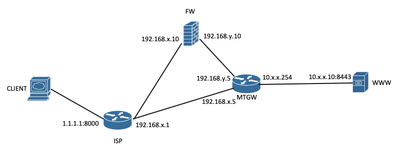

I have the following problem.
Configuration:
Incoming traffic goes from ISP 192.168.x.1 to my WAN interface 192.168.x.5.
But the default gateway on MT is set to 192.168.y.10 (firewall) and then it’s going to ISP 192.168.x.1
I need to expose the LAN www server 10.x.x.10 to the internet only for the selected public address e.g IP 1.1.1.1 on port 8000.
I see incoming traffic on MT WAN but the www server does not respond.
add action=dst-nat chain=dstnat comment=“DST-NAT2WWW”
dst-address=192.168.x.5 dst-port=8000 in-interface=WAN protocol=tcp
src-address=1.1.1.1 to-addresses=10.x.x.10 to-ports=8000
add disabled=no dst-address=0.0.0.0/0 gateway=192.168.y.10 pref-src=192.168.y.5 routing-table=main
I guess that missing is a static route only for that traffic but I’m not sure how to do it correctly.
I added a diagram to make the configuration more readable.

I do not understand your diagram. How is one device the ISP and yet you get internet from a device on the far right.
The only thing I can think of is MGTW is a the mikrotik device but not sure, it has a vlan that tags incoming WWW traffic from where, an ISP modem>?>>
takes that traffic to get terminated on the ISP router, which then provides internet to the upper firewall and then…
Sorry, no capiche
I understand that all settings should be done on the ISP router.
So based on your explanations, the issue is that the traffic goes from ISP router directly to MTGW one way, and from MTGW to FW the other way: the FW gets half a connection and drops it.
You have two possible ways forward:
  • Change your network so you have ISP ↔ FW ↔ MTGW, in which case the “FW” will do the translation from 192.168.x.5:8000 to 10.y.z.10:8443
  • Use policy-based routing (PBR) on the MTGW so the return traffic goes directly from MTGW to ISP.
The former is mostly reorganization and readdressing, nothing fancy nor difficult. The latter is all configuration changes, the easiest is to provide a full configuration export with the sensitive bits removed.
