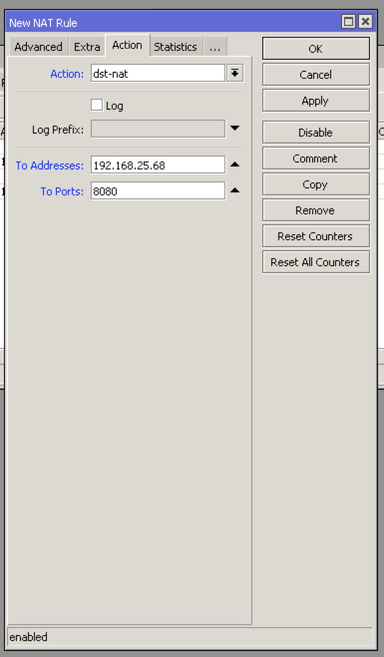

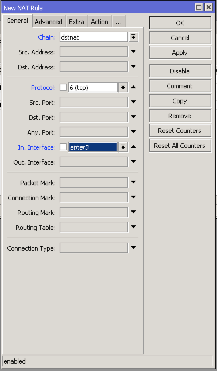

I was working on port forwarding, but I made a mistake and my router is not accessible ATM
the mistake was that I didnt enter any ip address or a Dst Port in the General tab of the firewall/NAT window
the following pictures shows the problem clearly
any way I can override this rule to access the router again ??

You should be able to reach the router by winbox
On the other hand, you configured the rule on ether3, what if you connect your cable to a different port
What type of router is it?
