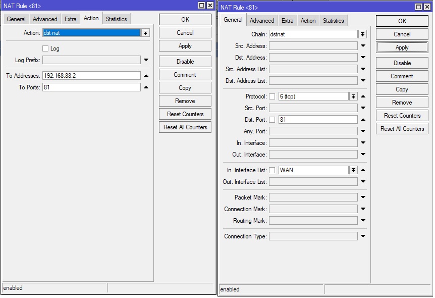

Attached pictures and text file showing config.

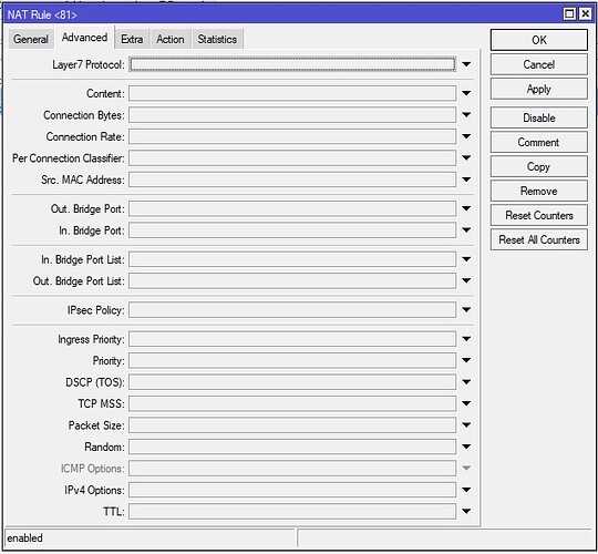

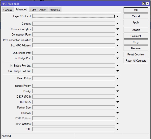

Attached is a screenshot of the Advanced tab.... Nothing much to see...
Any other ideas?
Ok, in the export is v7, my fault to not remember it, everytime specify RouterOS version.
Check on “General” if dst.address list is “white” or “gray” like src address list.
Must be gray, click on the arrow up at the end

Yep - greyed out - screenshots in original post

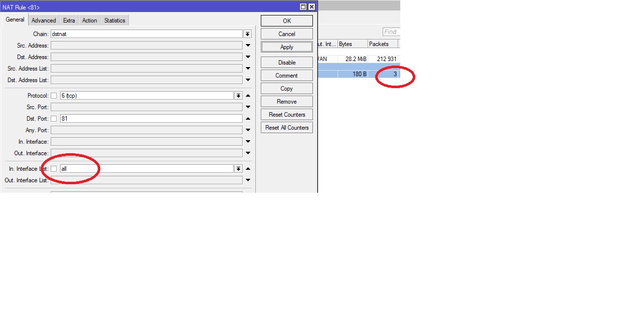

With In. Interface List set to WAN, zero traffic. But… If I change this to “all”, I seem to see traffic that matches this rule… But again, it never gets to the server (nothing in the logs)
