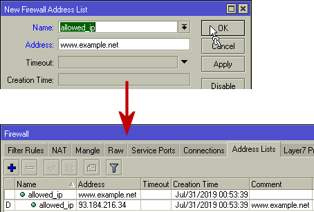

everything is up to date how do I do that in winbox do I have to run commands can you give me a step-by-step
The same works in WinBox too. Go to Address List tab, add new item, put name of list in “Name” field, FQDN in “Address”, click OK and that’s it.

I’m talking about this menu exactly the second picture with the arrow will the IP address under the FQDN update from time to time when the IP address changes because when you do it from NAT menu Source address and when you use over there a FQDN it fills in the IP address automatically but it never updates when the FQDN changes IP
But that’s the thing, you can’t use FQDNs with individual firewall rules, it doesn’t work there. You need to create address list and then use that instead. So instead of using src-address=, you make a list and use src-address-list=.
I just tested fqdn in address list and i change the IP and it updated instantly thanks for all your help
