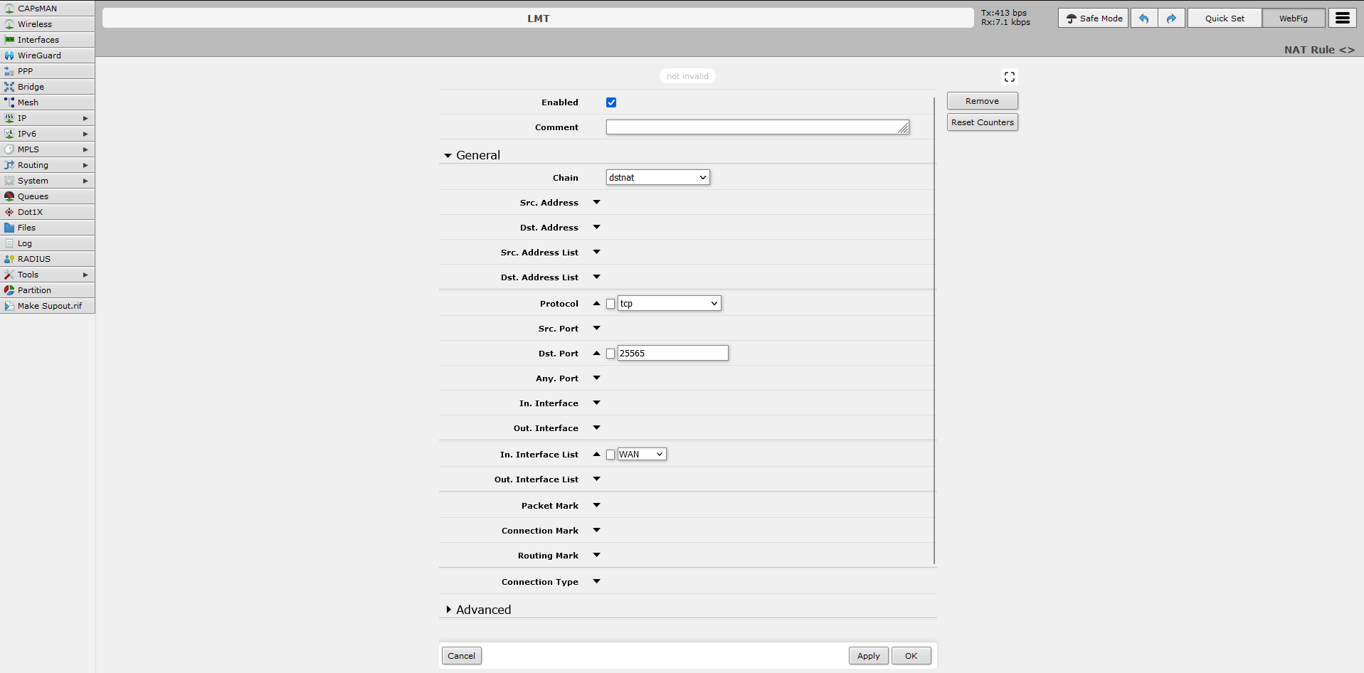

I have a 5G MikroTik router (I believe the model is the MikroTik LMT 5G R16) provided by my ISP, which is linked via ethernet to an Asus RT-AX92U, which is then linked to my PC via ethernet. I am attempting to do some port forwarding (specifically setting up a Minecraft server on my PC), however I seem to run into a problem where the MikroTik router doesn’t do any successful port forwarding to the Asus router (I have used this same router in a previous setup without the MikroTik router and it worked to my satisfaction). I have attached my MikroTik settings panel for port forwarding. I would appreciate suggestions for a solution.

What dest ip should the Mikrotik router forward this port to ?

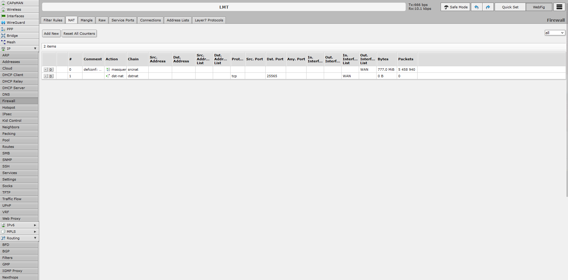

Not the best view, for us to look at. There is no to-addresses on that display, you would need to select the RULE you are talking about and expand the ACTION tab, to display the rule more fully.
The To-address should be the LANIP of the ASUS router ( on one of your MT lan subnets ).

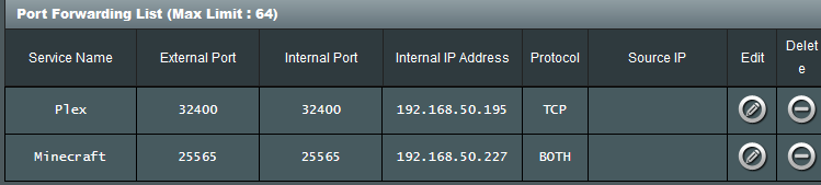

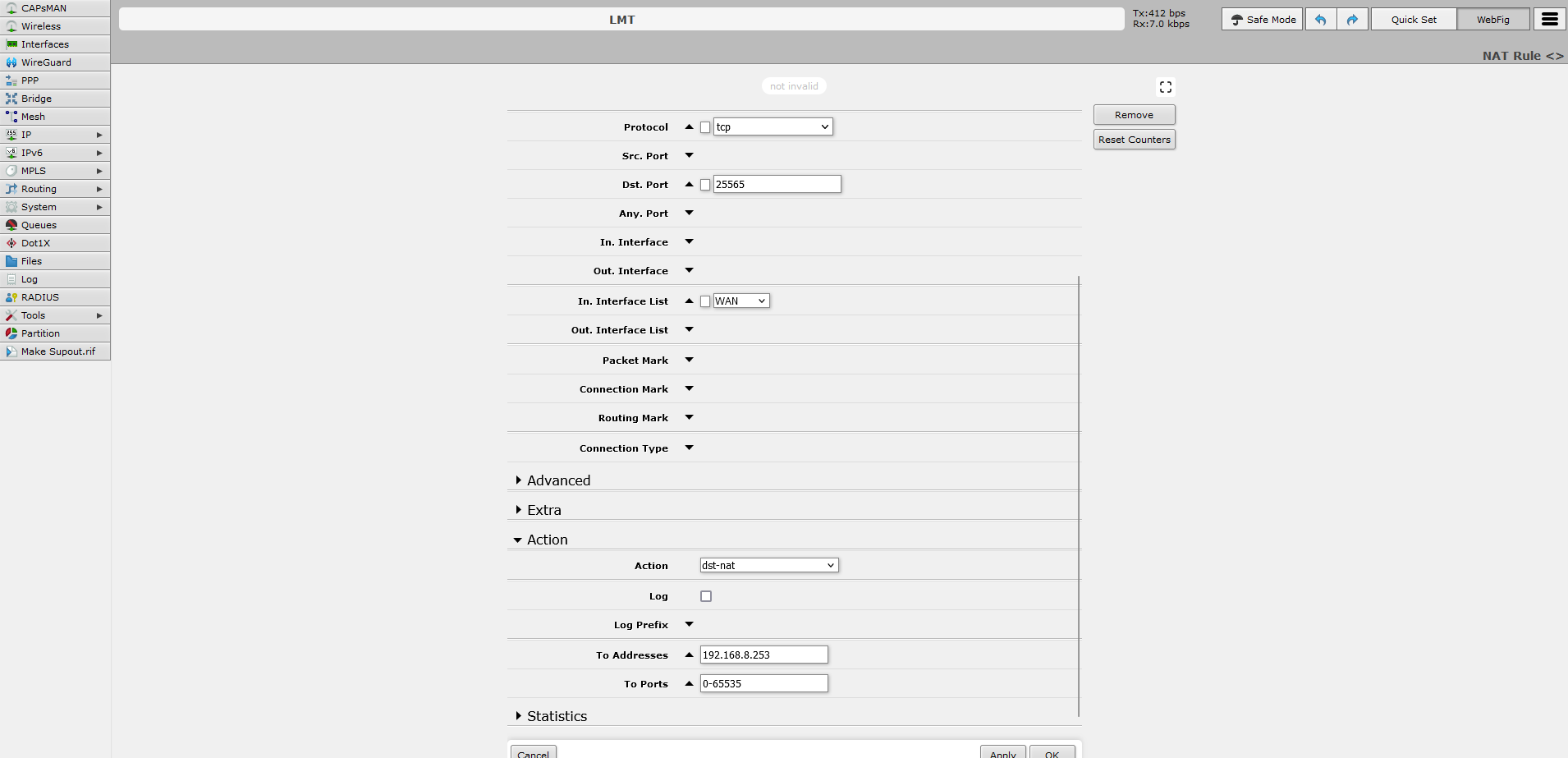

Thanks for the assistance. I have attached some additional screenshots - two with the expanded rule window (didn’t fit on one) as well as my ASUS router config screenshot, in case that is of any value. I am rather certain that my ASUS router IP is the one entered in the MikroTik settings, however there still seems to be no progress. I would appreciate a more detailed explanation of “disable routing”, as most of the instructions available online seem to be for a more complicated version of RouterOS. I am aware of this double NAT problem, however I am not experienced enough in networking to understand the solution for a MikroTik router. Many thanks for the help.

Well, nothing in your evidence shows that the IP of the asus is 192.168.8.253 but I assume it is.
Secondly your two ports should be the same as your dst-port or blank ( as the router will assume its the same with no entry).
What is in there now 0-6535 is incorrect.
