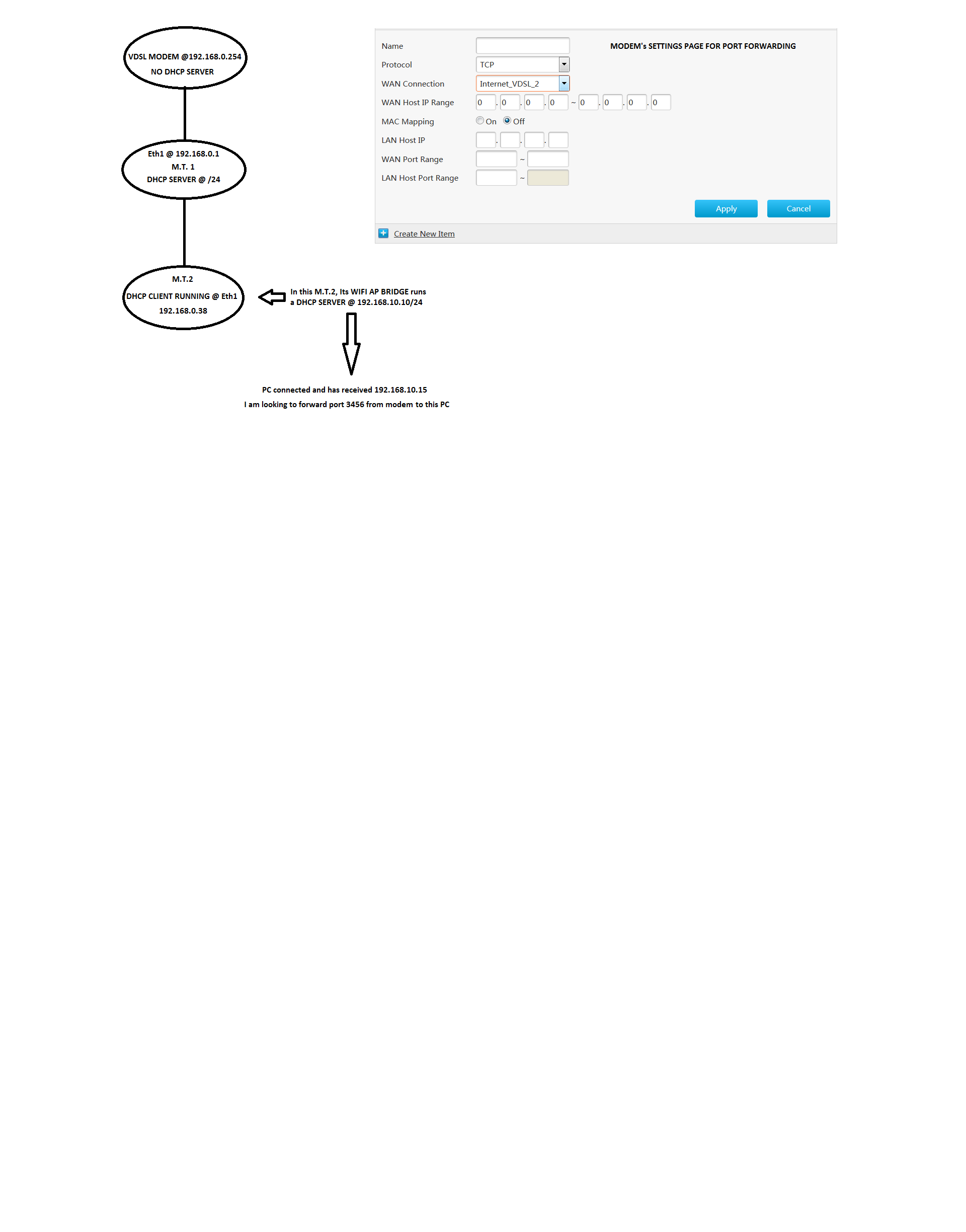

Hi Everyone, I am including a design of what I am looking to do and boy oh boy have I had my head scratching on how to port forward 3456 from my VDSL modem to a PC connected to M.T.2 WIFI .
I have included the rule in the modem’s settings page but the port remains closed! I have tried with dstnat rules in both MTs but still can’t figure it out. Can you please help?
Thank you !

You must simply port forward the port 3456 from your VDSL router to Mikrotik 1 and then portforward from Mikrotik 1 to Mikrotik 2 and then port forward from Mikrotik 2 to your PC…
Thank you Zacharias, to be honest I don’t remember after so many tries if I did that, so I went and I forwarded from my modem port 3456 to M.T1. @ 192.168.0.1 with dstnat to 192.168.0.38 (MT2-Eth1), then the same dst nat from 192.168.0.38 (MT2 - Eth1) to 192.168.10.15 (PC) and still the port is closed.
Even by opening the port from the modem to M.T.1 without continuing the sequence. shouldn’t the port appear as open? I mean if you have forwarded a port to a pc and that PC is turned of because the port is open on the modem shouldn’t it appear open even though the PC is off?
Should I be including the source address on the MT’s as well? I do everything from WinBox…just wanted to make sure.
If modem and both MT routers are in same 192.168.0.0/24 (is MT1 just bridge?), then forward port from modem directly to MT2’s address. You should probably share more details about how is everything configured, because it seems a little strange, it’s not clear what’s MT1 doing there.
And no, opening ports works in different way. Port is open when you connect to it and something responds. It’s closed when (in simple words) something responds and tells you it’s closed. If nothing responds, it’s usually called that port is filtered. When you forward port somewhere, the device just changes destination and sends packets there, it doesn’t otherwise interfere. So from outside, you can’t really tell how far it went, if the problem is with modem, next router or target PC.
Hi Sob, so would you say that in order for a port to appear open something has to “κnock” and something has be awaiting to respond to that “knock” and open it? In other words when I try an open-port-check-tool from the Internet to 3456 because there is no device waiting to reply back, the port appears as not open? If that is the case I believe I am getting to it…
My modem is a regular ISP basic modem and I have turned off its wifi and its DHCP server and given it a static IP. One of its ports is connected on a switch and on that switch M.T1. is also connected together with M.T2 . On the rest of the modem’s ports there are other devices that receive IP addresses through M.T.1 (the modem works as a switch)
M.T.1 runs the DHCP server and through a pool, hands in addresses to devices that connect to it, through physical ports and its WIFI AP. The ports and the Wifi AP are all bridged . The address of the network is 192.168.0.0/24 .
Where everything physically is, I need to have a separate subnet (thus the 192.168.10.0/24) and have given to MT2’s WIFI AP bridge address: 192.168.10.10, this latter one also runs a DHCP server and gives out through a pool address 192.168.10.15 that I need to access from the Internet through port 3456 . The Ethernet of M.T2 runs a DHCP client and receives an address from M.T.1: 192.168.0.38
I tried to put it as simple as possible to avoid confusing you and the members,apologies if I didn’t succeed, but please let me know if you need any more info and I will get right back.

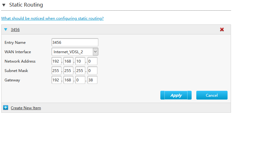

b) On modem, if it has such option, add static route to 192.168.10.0/24 via 192.168.0.38. Then forward port from modem directly to 192.168.10.15. And you also won’t need NAT on MT2 at all.

Thank you @ Sob, things are more clear now ! I followed your advice as well and still port remains closed. I will attach the rule I entered in the modem.
