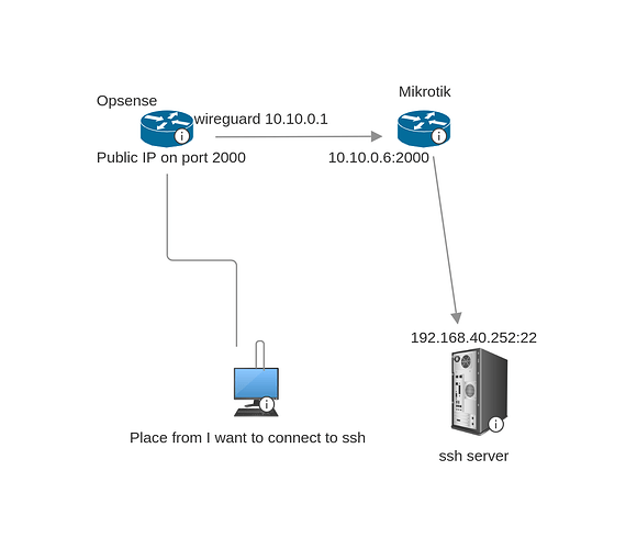

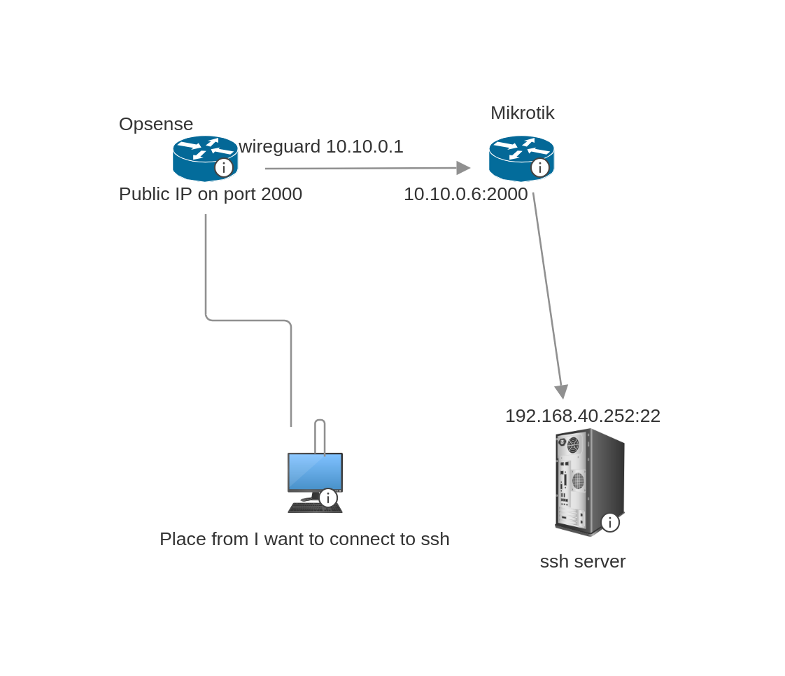

Didnt understand anything in the first paragraph, please add a network diagram.
Thanks for the reply. I want to connect to the ssh server which is behind my mikrotik. Mikrotik itself does not have public IP so I forward the connection with wireguard.
On my PC I want to connect to ssh on port 2000 to my opnsense. Then it should be forwarded to mikrotik and then to the ssh server. As I said before I can see the connection on the ssh server, but it probably does not go back to my pc.
I hope this is more clear.
