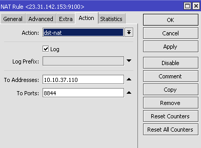

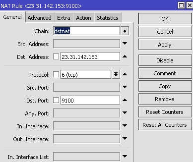

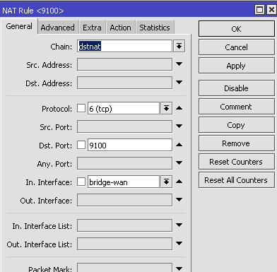

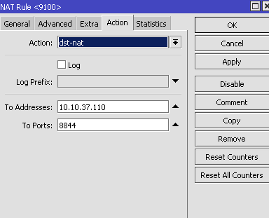

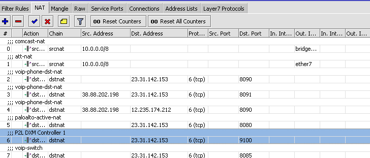

Here is what I am trying to get accomplished,
  1. external IP 23.31.142.153 to forward to an internal → IP of 10.10.37.xxx:8844
Here is what I have done.
  1. set up a NAT like this
General Tab:
dstnat
Dst Address: 23.31.142.153
protocal: 6 (tcp)
Dest Port: 9100
Action tab:
dst-nat
To Address: 10.10.37.110
To Port: 8844
When testing this I am seeing the following
nc -vz 23.31.142.153 9100
nc: connectx to 23.31.142.153 port 9100 (tcp) failed: Network is unreachable
Is there something I am missing? I will attached some screenshots here as well…
Also please let me know if you need any other information.
Please advise..

There is only one NAT section in firewall rules (not a general and an action - why make shit up??_
dstnat rule format is
add action=dst-nat chain=dstnat dst-port=9100 protocol=tcp in-interface-list=WAN
to-address=10.10.37.xxx to-ports=8844

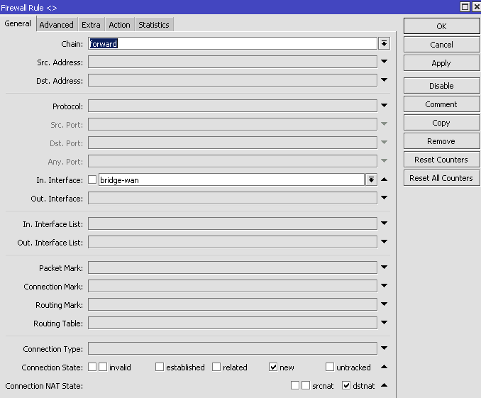

What one must ensure is that in the Forward Chain of the /ip firewall filter rules,
that one has a rule to allow Destination NAT,
Something like.
add action=accept chain=forward comment=“allow port forwarding” in-interface-list=WAN
connection-nat-state=dstnat connection-state=new

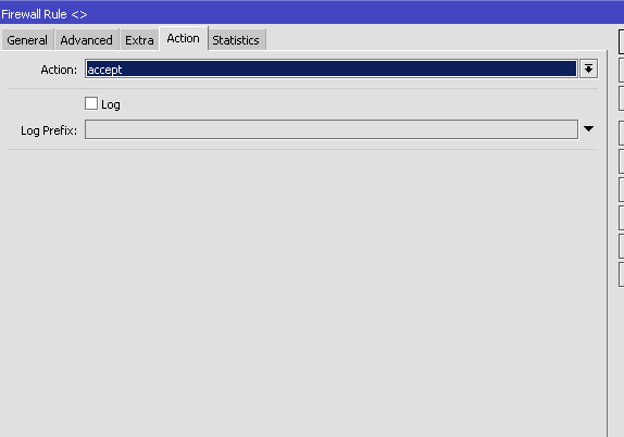

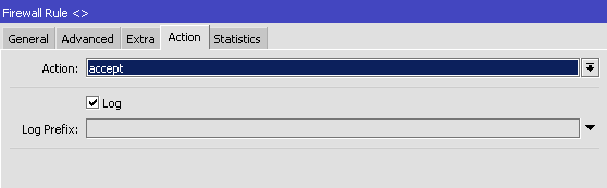

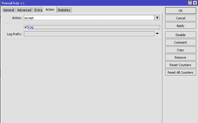

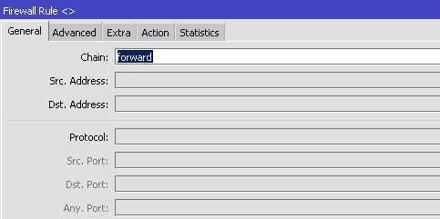

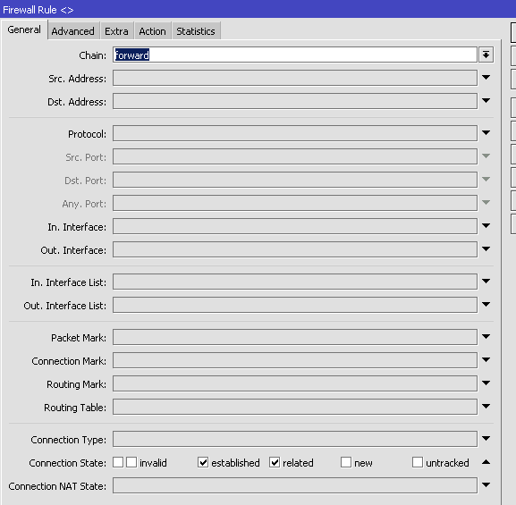

Here is my forward filter rule attached. Do I need to create another one or can I just use this existing one attached?
I have added the In. Interface to “bridge-wan”
Still not working. Please advise I really need to get this to work.
Thank you for your time.

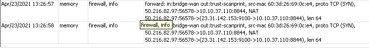

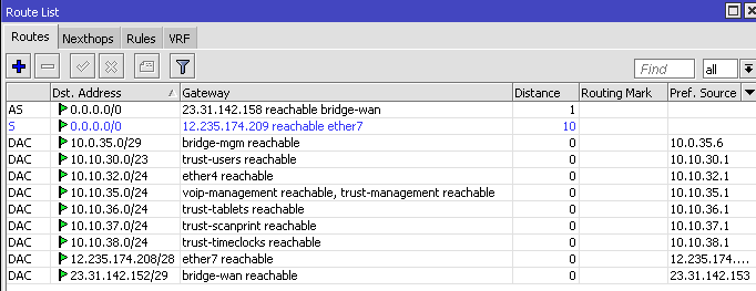

Ok did what was recommended and no go. Please see attachments.
Please tell me what I am missing ..
still getting this
Please advise and see the attachments

add action=accept chain=forward comment="Allow port forwarding"
connection-nat-state=dstnat connection-state=new in-interface=bridge-wan
log=yes

add action=dst-nat chain=dstnat comment=voip-phone-dst-nat dst-address=
23.31.142.153 dst-port=8090 protocol=tcp src-address-list=homechef
to-addresses=10.10.32.216 to-ports=80
23.31.142.153 dst-port=8091 protocol=tcp src-address=38.88.202.198
to-addresses=10.10.32.212 to-ports=80
12.235.174.212 dst-port=8090 protocol=tcp src-address=38.88.202.198
add action=dst-nat chain=dstnat comment=paloalto-active-nat dst-address=
23.31.142.153 dst-port=8080 protocol=tcp src-address-list=homechef
to-addresses=10.0.35.1 to-ports=443
add action=dst-nat chain=dstnat comment=voip-switch dst-address=23.31.142.153
dst-port=8085 protocol=tcp src-address-list=homechef to-addresses=
10.10.35.21 to-ports=443
add action=dst-nat chain=dstnat comment=paloalto-active-nat-ssh dst-address=
23.31.142.153 dst-port=2222 protocol=tcp src-address=38.88.202.198
to-addresses=10.0.35.1 to-ports=22
add action=dst-nat chain=dstnat comment=paloalto-passive-nat dst-address=
23.31.142.153 dst-port=8081 protocol=tcp src-address-list=homechef
to-addresses=10.0.35.2 to-ports=443
add action=dst-nat chain=dstnat comment=paloalto-passive-nat-ssh dst-address=
23.31.142.153 dst-port=2223 protocol=tcp src-address=38.88.202.198
to-addresses=10.0.35.2 to-ports=22
add action=dst-nat chain=dstnat comment="P2L DXM Controller 1" dst-address=
23.31.142.153 dst-port=9100 log=yes protocol=tcp to-addresses=
10.10.37.110 to-ports=8844

Luv to help but I am having trouble imagining the network without a diagram.
I dont see clealry how many WAN connections you have, nor the reason for a second bridge for the WAN.
I have no clue why none of your VLANs are interfaced to a bridge…
Therefore a network diagram and what is going for each port will allow one to accurately find the problems in the config (there seem to be many).
Youve asked for an 10 minute oil change but it looks like a fully day repair LOL.
Please tell me what you need from me to help and make this easier. I think you get the idea of what i am trying to accomplished and I have set NAT up before in which are working, but for some reason on this one is not working and it appears to say network not found
Which I am assuming there is an issue hitting the 10.10.37.xxx network since I see the stuff getting to this 23.31.142.153.
I have provided you with the config, but not sure what else you need. We do have two bridges one being “bridge-wan” and the other 'bridge-mgm"
Please let me know what else you need to assist me. I really need to get this working.
Thanks again.
Thanks again.
That forward rule with the flag “dnat” ? Can you uncheck “new” please ?
The NEW state tells us that the packet is the first packet that we see. This means that the first packet that the conntrack module sees, within a specific connection, will be matched.
For example, if we see an SYN packet and it is the first packet in a connection that we see, it will match;

Looking at his log snippet it states 50.216.82.97 as source so I think he is really testing coming in externally.
first of all, you locally can access 10.10.37.110:8844 from another 10.x.x.x device???

for test add this two rules on top of the others:
add action=accept chain=input src-address=50.216.82.97
add action=accept chain=forward src-address=50.216.82.97

the rule yoiu add has no error from my point of view:
add action=dst-nat chain=dstnat comment=“P2L DXM Controller 1” dst-address=23.31.142.153 dst-port=9100 log=yes protocol=tcp to-addresses=10.10.37.110 to-ports=8844
I get the feeling that you didnt create this config because you didnt uderstand the request for a network diagram which would explain the Inputs on the WAN side and the networking setup involved, devices and ports etc…

What the export say without any diagram:
The factory firmware of the device are 6.38.5.
The routerboard are upgraded to 6.46.4 without using netinstall, keeping old default values of 6.38.5 and following version.
Has the wireless package active but ipv6,hotspot,mpls,routing packages like disabled.
the sfp port is empty or unused
Has two wan, one 23.31.142.152/29 and one 12.235.174.208/28
the wan 23.31.142.152/29 are the default wan
and the 12.235.174.208/28 are secondary wan
second wan is used only if ping on 23.31.142.158 stop reply on ping
has two bridge and two ethernet:
bridge-wan used as WAN1 23.31.142.153/29
ether1 wan-comcast (WAN1 source)
ether2 paloalto-comcast
ether3 comcast-cameras-mikrotik
bridge-mgm with dhcp server on ranges=10.0.35.1-10.0.35.2
ether5 palo-alto-management-failover
ether6 palo-alto-management (error: 10.0.35.6/29, the IP go to bridge, not to ethernet on bridge)
ether4 voip 10.10.32.1/24 with dhcp server active on ranges=10.10.32.20-10.10.32.220
ether7 att-backup used as WAN2 12.235.174.212/28
On ether7 are present some VLANs
trust-users 10.10.30.1/23 vlan-id=30 dhcp-server on ranges=10.10.30.20-10.10.31.220
trust-management 10.10.35.1/24 vlan-id=35 dhcp-server on ranges=10.10.35.200-10.10.35.254
trust-tablets 10.10.36.1/24 vlan-id=36 dhcp-server on ranges=10.10.36.20-10.10.36.254
trust-scanprint 10.10.37.1/24 vlan-id=37 dhcp-server on ranges=10.10.37.20-10.10.37.254
trust-timeclocks 10.10.38.1/24 vlan-id=38 without any dhcp
and on ether4 VLAN
voip-management 10.10.35.1/24 vlan-id=35 dhcp-server on ranges=10.10.35.200-10.10.35.240
BAD: VLAN 35 on ether4 and VLAN 35 on ether7 are not communicating with eachoter and share the pool
but this is not hte problem
