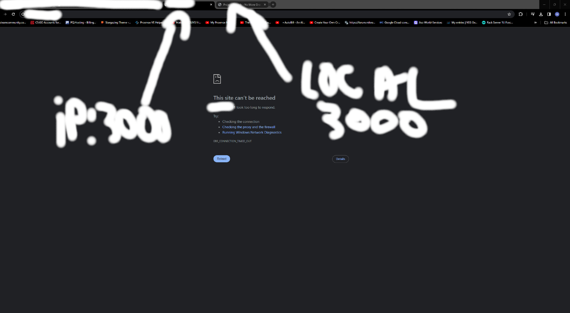

also when i try to remove /24 itgoes to /32 and kills my internet when I edit the in interface for DST thing it doesn’t send anything like it did like no packets no nothing
This site can’t be reached redactedIP refused to connect.

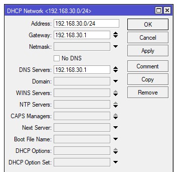

/ip dhcp-server network { no entry for netmask required }
add address=192.168.88.0/24 dns-server**=192.168.88.1** gateway=192.168.88.1

Bcs If I change the to address to my Public Ip / PPPoE address then it will route from dst address which is PPPoE address to pppoe address
also ye I tried my Lan ip in dst adress and gives no packets
Also refrencing any In. Interface such as Ether 1 pppoe 3 or bridge it just straight up doesnt send the packets back. (from what I know it should atleast send packets to know if it makes contact even if it’s not permited)

  1. I’m still new to mikrotik routers, also this is just to experiment with friends and to use as a VPN, I don’t intend to making it publicly available!
    2.I tried with In. Interface making it pppoe3-out but nothing happens like literally no packets sent
Also sorry for my stupid responses but I’m new I wanted to try smth more complicated and understand how it works!
Then the packets aren’t coming in over the pppoe3-out interface. Stop focusing on this port forwarding side issue and debug the main issue.
