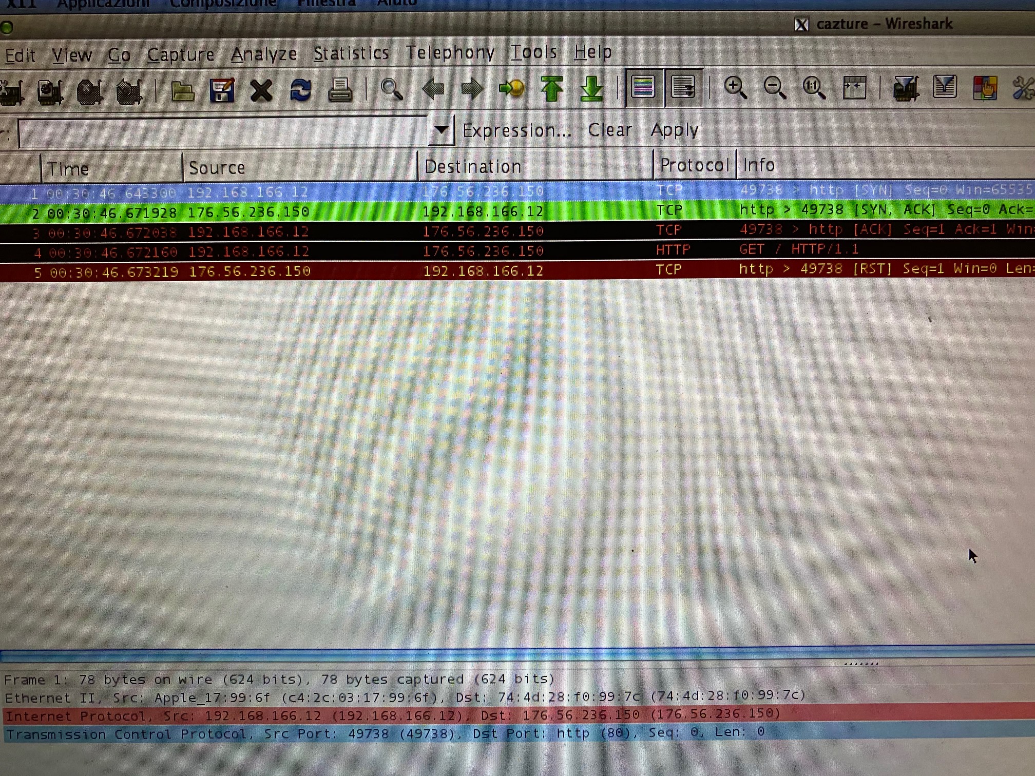

After better looking at the capture on client (192.168.166.12) the TCP handshake is completed, then remote sends an RST. See screenshot…
Further tests… sometimes the http connection completes, sometimes it gets reset.
Puzzled…
