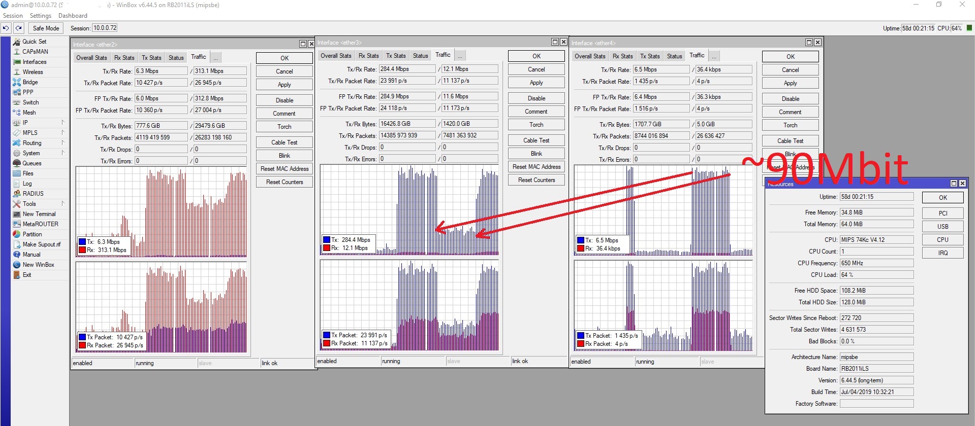

If both clients receive (or transmit) data at the same time and client2 traffic is over ~80Mbit, client1 speed reduced to ~95Mbit.
CPU load is only ~45-50%
If client2 move to ether6-10 then client1 speed isn’t downgraded.
