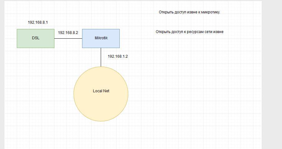

I have a DSL router Lancom with real ip address 80.xx.xx.xx without dhcp server. Mikrotik is connecting to it with static ip address from 192.168.2.0/24. So they are in the same network. Mikrotik keeps it’s DHCP Server - 192.168.1.0/24. I can’t forward port neither on webinterface of mikrotik, or to a pc inside dchp pool of mikrotik. I add port forwarding rule on DSL router, e.g. 8080 port on the ip of MT - 192.168.2.2 to access the webinterface from the internet, and tried out different configurations of the filter rules and NAT solutions with dst-nat on Miktotik, but in vain.

Try to narrow problem and first configure mikrotik to pass 192.168.8.x to 192.168.1.x while are you connected to 192.168.8.x network.
If you will be able to access local net then you will be sure that MKT router works.
Then start checking if access from outside DSL model works or not.
Firewall rule order matters! Move filter rule 7 above 6. You are currently dropping everything not established or related.
I can access from local to dsl and mikrotik catch the internet and provide it to our local net. The problem is that mikrotik’s web interface is unreachable from the outside. I connect via DSL and get ip “80.x.x.x”, I want to make web accessable on it. 80.x.x.x:8089. If it works, I can forward the other ports for ssh or web to local net.
