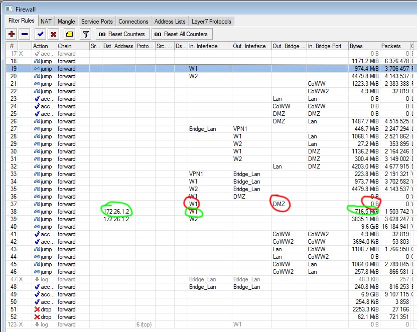

I use these rules on more firewalls 2.9.xx and bridge filtering work fine. On ROS 3.x I have problem. Some packets catch on this rule, but some not.
I try your example as first think, last week. I find out, that some traffic like as “not new connection state”, and “not established”! I think so.
When I use:
chain=forward action=accept connection-state=new in-interface=Bridge out-inteface=Bridge
… filtering work fine !
… or when I use src.address or dst.address filtering instead bridge port filtering … filtering work fine.
… but bridge port filtering … problem ![]()

Some rules used bridge port work fine, but some not.
Example:
When I use combination bridge port W1 (eth) and DMZ (bridge port) rule not work !
or LAN (bridge port) and CoWW (bridge port) not work wery well.

When I use filtering combination every bridge port :
Lan - DMZ - accept (cons.state=new)
Lan - CoWW - accept (cons.state=new)
Lan - Coww2 - accept (cons.state=new)
DMZ - Lan - accept (cons.state=new)
DMZ - … - accept (cons.state=new)
finaly I use rule
Bridge - Bridge - accept (cons.state=new)
… counter of this rule count some traffic ! Why? This traffic must be zero and partial traffic must be catched on partial rules. I think so.
