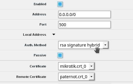

Consider the following export line:
add address=0.0.0.0/0 auth-method=rsa-signature-hybrid comment=RSA dpd-interval=1m enc-algorithm=aes-128,3des,des generate-policy=port-strict hash-algorithm=md5 local-address=0.0.0.0 mode-config=RW-cfg passive=yes policy-template-group=rsa remote-certificate=paternot.crt_0
  1. Compare it with the screenshot I sent. Shouldn’t the certificate “mikrotik.crt_0” appear in the export line?
  2. When I erase all IPSEC configs, and try to do a restore, it fails - exactly on this line. The error message is: “failure: certificate not set”. If I erase this line from the backup file, the restore works. Of course, I have to reenter this line info by hand.
I included the export of /ip ipsec peers, where You can see the line does not mention the “mikrotik.crt_0” file.
I also included the export of “/certificate”.
So. Did I do something wrong? Or it is really a bug? Nevermind the passwords in the file: this is a test setup.
