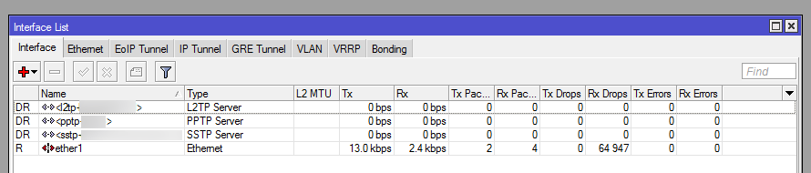

I just had a server that started loosing packets. I attached the interface screenshot below. Most clients already dropped off, but there are some still connected, showing 0 traffic - due to the packet loss. This is version 5.0 . RX drops seems to be high, but I have that on other installations as well - so that may not be a factor.
I also created a supout.rif file in that state of the router. I’m sending that to support.
What is CPU usage like on the device at this time?
I already rebooted, so I don’t have an actual answer, but if my memory serves right, it goes to 0%. So it doesn’t look like a deadlock.

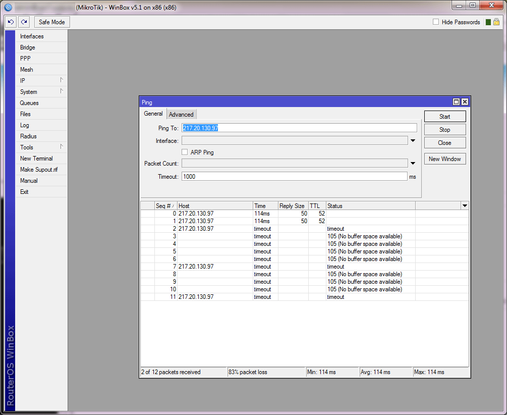

I was able to send the supouts to support today. I also found an actual error that could be related to this problem. Please see screenshot below … there could be many other factors involved, but my money is on memory leak now.
