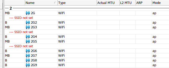

And after running the provisioning step I get some interfaces with missing ssid:
Is this normal behaviour or is this a bug? I think normally the missing configuration in the provisioning entries should ideally provision nothing and never create interfaces.
