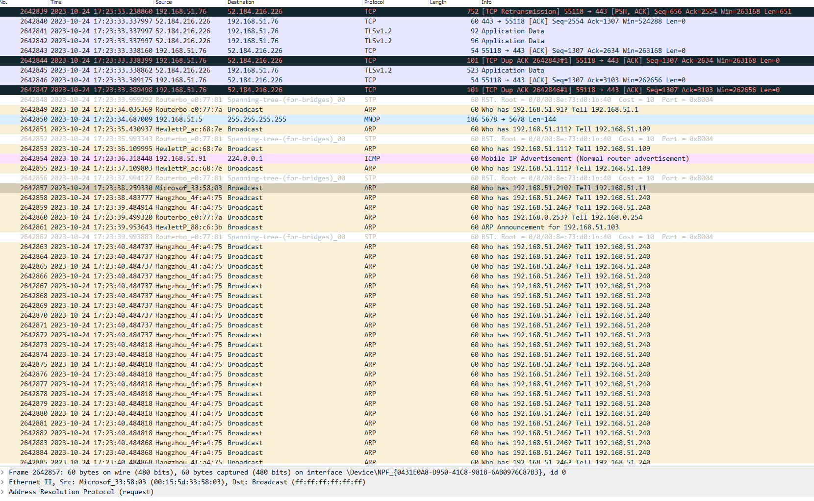

Now what seems to happen before/during the disconnect is that the network gets flooded by a few million ARP requests over the span of a few seconds. Is it possible for ARP requests to flood a network so badly it disconnects for a few seconds? In the screenshot the 192.168.51.246 address belongs to a HIKVISION camera. The peculiar thing however, is that during each flood the device sending the requests changes. In a different Wireshark output, the device making the requests was a RBwAPR-2nD&R11e-LTE. After removing the IP requested during the flood from the table of the LTE, a different device was sending the requests consecutively.

Are there any other steps I can take to get to the bottom of what is causing this?

It’s a broadcast storm it’s either malicious or you have a network clash.
The first obvious question is you have VLANs why are the cameras on the same VLAN as everything else???
Much easier to diagnose and put queue rate limits on stuff if it isn’t all in the same VLAN.
