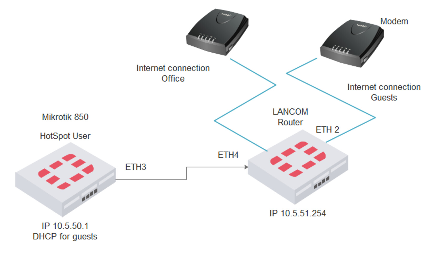

My MT 850 has gor two bridges: one for OFFICE users (192.168.0.x/24) and other for GUESTS user (10.5.50.0/23). MT Hotspot resp bridge guests has ip 10.5.50.1.MT is connected via Eth3 (which i put to bridge guests) to LANCOM router to Eth4. LANCOM should be doing following: connections from ip subnet 10.5.50.0/23 (connected to MT) should have internet connection via MODEM on LANCOM Eth3. The LANCOM support did that and if i connect with my laptop (fix IP address) i see connection via Eth3 which is fine. And here is my issue.
i have connected MT via Eth3 to LANCOM to Eht4 and i see in MT DHCP lease IP address from LANCOM but i can not ping it resp I do not have connection to 10.5.51.254. Is this a matter of routing?

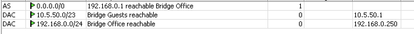

This is my current routing table:

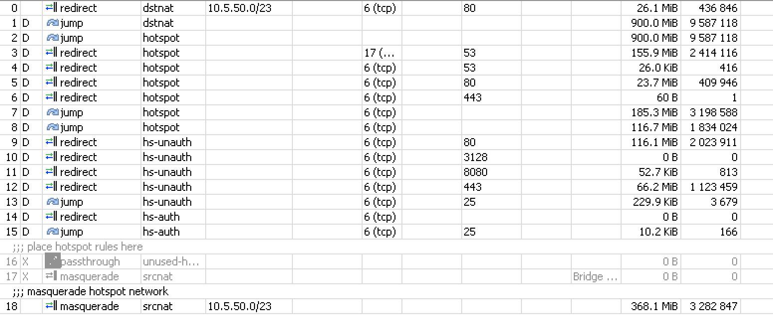

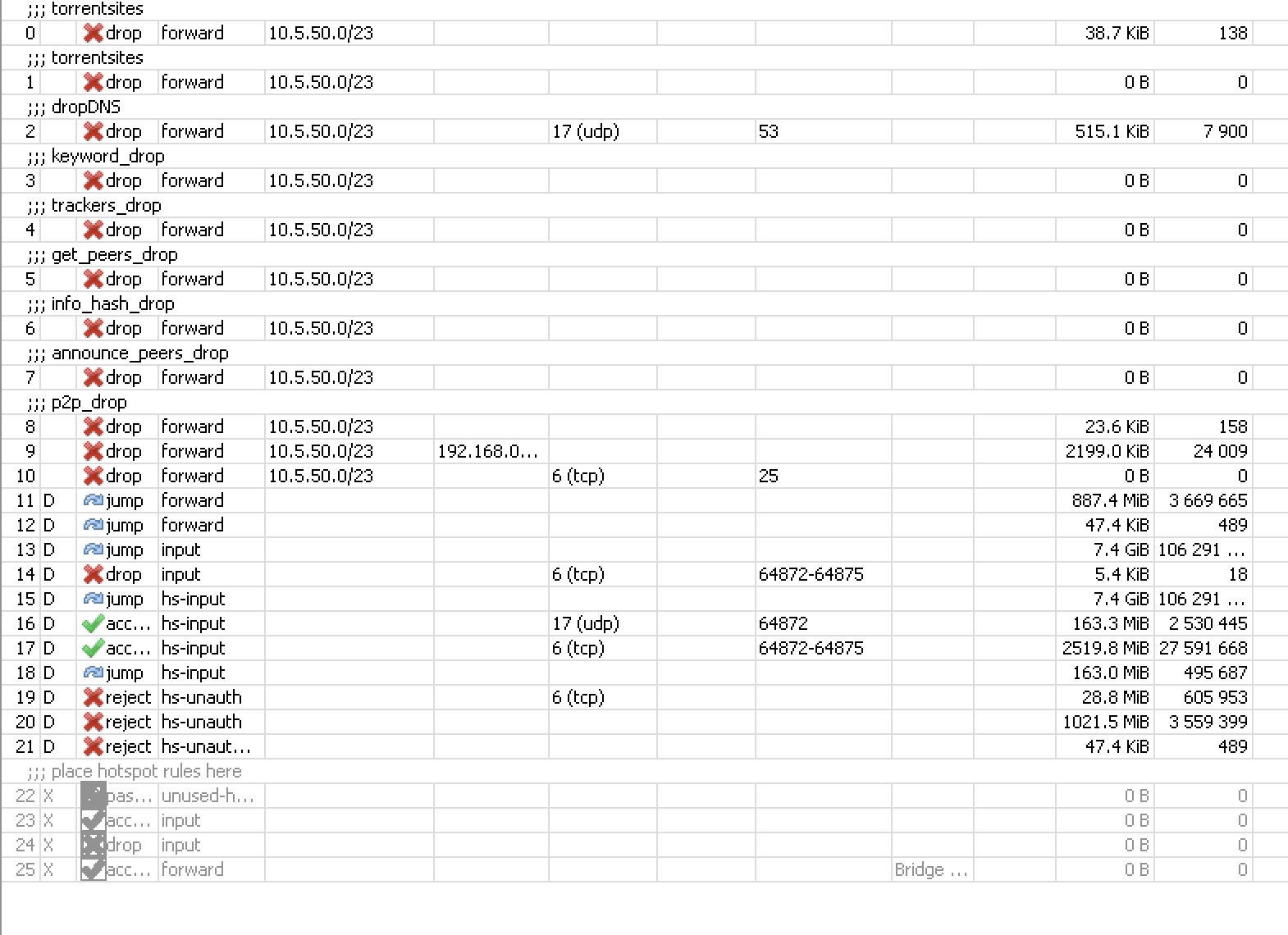

pls provide full config or screenshot of firewall and NAT
Did you use Wizard ?
Yes.. i did
