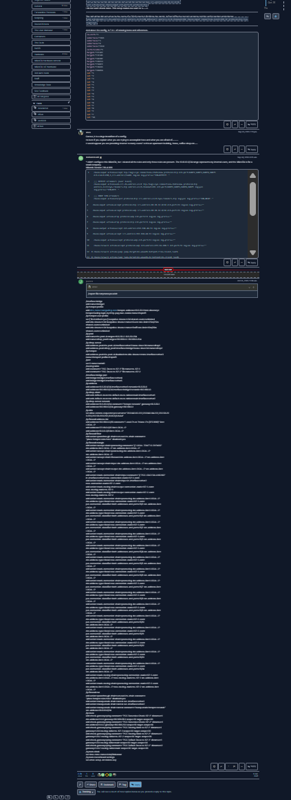

“I didn’t configure this MikroTik, but I cleared all the rules and only these rules are present. The 10.10.12.0/24 range represents my internal users, and the MikroTik is for a small company.
Mikrotik Version 7.19.4 X86
 1    chain=input action=accept tcp-flags=syn connection-state=new protocol=tcp dst-port=64872,64873,64874,64875
      dst-limit=200,1,src-address/1m40s log=no log-prefix="SYN-DETECT: "
 2    ;;; DETECT offenders (over limit)
      chain=input action=add-src-to-address-list tcp-flags=syn connection-state=new protocol=tcp
      address-list=Syn-flooders-tcp address-list-timeout=20s dst-port=64872,64873,64874,64875 log=yes
      log-prefix="SYN-DET: "
 3    ;;; DROP SYN offenders
      chain=input action=tarpit protocol=tcp src-address-list=Syn-flooders-tcp log=yes log-prefix="SYN-DROP: "
4    chain=input action=accept protocol=tcp src-address=10.10.12.0/24 dst-port=53 log=no log-prefix=""
5    chain=input action=accept protocol=udp src-address=10.10.12.0/24 dst-port=53 log=no log-prefix=""
6    chain=input action=drop protocol=udp dst-port=53 log=no log-prefix=""
7    chain=input action=drop protocol=tcp dst-port=53 log=no log-prefix=""
8    chain=output action=accept dst-address=192.168.44.93 log=no log-prefix=""
9    chain=input action=accept src-address=192.168.44.93 log=no log-prefix=""
10    chain=input action=accept protocol=udp dst-port=53 log=no log-prefix=""
11    chain=forward action=accept protocol=udp dst-address=172.16.200.5 dst-port=53 log=no log-prefix=""
12  D chain=forward action=jump jump-target=hs-unauth hotspot=from-client,!auth
13  D chain=forward action=jump jump-target=hs-unauth-to hotspot=to-client,!auth
14  D chain=input action=jump jump-target=hs-input hotspot=from-client
15  D chain=input action=drop protocol=tcp hotspot=!from-client dst-port=64872-64875
16  D chain=hs-input action=jump jump-target=pre-hs-input
17  D chain=hs-input action=accept protocol=udp dst-port=64872
18  D chain=hs-input action=accept protocol=tcp dst-port=64872-64875
19  D chain=hs-input action=jump jump-target=hs-unauth hotspot=!auth
20  D chain=hs-unauth action=reject reject-with=tcp-reset protocol=tcp
21  D chain=hs-unauth action=reject reject-with=icmp-net-prohibited
22  D chain=hs-unauth-to action=reject reject-with=icmp-host-prohibited
 23    ;;; Allow established/related
      chain=forward action=accept connection-state=established,related log=no log-prefix=""
24    ;;; Drop invalid connections
      chain=forward action=drop connection-state=invalid log=no log-prefix=""
add name=bridge1
/ip hotspot profile
add dns-name=sarigading.com hotspot-address=10.5.50.1 html-directory=
hotspotGading login-by=http-pap,mac-cookie name=hsprof1
/ip hotspot user profile
set \[ find default=yes \] keepalive-timeout=3d shared-users=unlimited
add idle-timeout=3d !keepalive-timeout name=Guest rate-limit=25m/25m
add idle-timeout=3d !keepalive-timeout name=Staff rate-limit=10m/10m
add name=hs-pool-4 ranges=10.5.50.2-10.5.50.254
add name=dhcp_pool1 ranges=192.168.1.2-192.168.1.254
add address-pool=hs-pool-4 interface=ether3 lease-time=3d name=dhcp1
add address-pool=dhcp_pool1 interface=bridge1 lease-time=3d name=dhcp2
/ip hotspot
add address-pool=hs-pool-4 disabled=no idle-timeout=none interface=ether3
name=hotspot1 profile=hsprof1
/port
set 0 name=serial0
/routing table
add comment="PCC Route to ISP-1" fib name=to-ISP-1
add comment="PCC Route to ISP-2" fib name=to-ISP-2
add bridge=bridge1 interface=ether4
add address=10.5.50.1/24 interface=ether3 network=10.5.50.0
add address=192.168.1.1/24 interface=bridge1 network=192.168.1.0
/ip dhcp-client
add add-default-route=no default-route-tables=main interface=ether1
add add-default-route=no default-route-tables=main interface=ether2
add address=10.5.50.0/24 comment="hotspot network" gateway=10.5.50.1
add address=192.168.1.0/24 gateway=192.168.1.1
set allow-remote-requests=yes servers="203.142.82.222,203.142.84.222,202.58.20
3.203,202.58.203.202,8.8.8.8,8.8.4.4"
/ip firewall address-list
add address=192.168.0.0/16 comment="Local IPs or Private IPs (RFC1918)" list=
LOCAL-IP
add address=172.16.0.0/12 list=LOCAL-IP
add address=10.0.0.0/8 list=LOCAL-IP
add action=passthrough chain=unused-hs-chain comment=
"place hotspot rules here" disabled=yes
/ip firewall mangle
add action=accept chain=prerouting comment="// LOCAL TRAFFIC BYPASS"
dst-address-list=LOCAL-IP src-address-list=LOCAL-IP
add action=accept chain=postrouting dst-address-list=LOCAL-IP
add action=accept chain=forward dst-address-list=LOCAL-IP src-address-list=
LOCAL-IP
add action=accept chain=input dst-address-list=LOCAL-IP src-address-list=
LOCAL-IP
add action=accept chain=output dst-address-list=LOCAL-IP src-address-list=
LOCAL-IP
add action=mark-connection chain=input comment="// PCC LOAD BALANCING"
in-interface=ether1 new-connection-mark=ISP-1-conn
add action=mark-connection chain=input in-interface=ether2
new-connection-mark=ISP-2-conn
add action=mark-routing chain=output connection-mark=ISP-1-conn
new-routing-mark=to-ISP-1
add action=mark-routing chain=output connection-mark=ISP-2-conn
new-routing-mark=to-ISP-2
add action=mark-connection chain=prerouting dst-address-list=!LOCAL-IP
dst-address-type=!local new-connection-mark=ISP-1-conn
per-connection-classifier=both-addresses-and-ports:15/0 src-address-list=
LOCAL-IP
per-connection-classifier=both-addresses-and-ports:15/1 src-address-list=
LOCAL-IP
per-connection-classifier=both-addresses-and-ports:15/2 src-address-list=
LOCAL-IP
per-connection-classifier=both-addresses-and-ports:15/3 src-address-list=
LOCAL-IP
per-connection-classifier=both-addresses-and-ports:15/4 src-address-list=
LOCAL-IP
per-connection-classifier=both-addresses-and-ports:15/5 src-address-list=
LOCAL-IP
per-connection-classifier=both-addresses-and-ports:15/6 src-address-list=
LOCAL-IP
per-connection-classifier=both-addresses-and-ports:15/7 src-address-list=
LOCAL-IP
dst-address-type=!local new-connection-mark=ISP-2-conn
per-connection-classifier=both-addresses-and-ports:15/8 src-address-list=
LOCAL-IP
per-connection-classifier=both-addresses-and-ports:15/9 src-address-list=
LOCAL-IP
per-connection-classifier=both-addresses-and-ports:15/10
per-connection-classifier=both-addresses-and-ports:15/11
per-connection-classifier=both-addresses-and-ports:15/12
per-connection-classifier=both-addresses-and-ports:15/13
per-connection-classifier=both-addresses-and-ports:15/14
add action=mark-routing chain=prerouting connection-mark=ISP-1-conn
dst-address-list=!LOCAL-IP new-routing-mark=to-ISP-1 src-address-list=
LOCAL-IP
add action=mark-routing chain=prerouting connection-mark=ISP-2-conn
dst-address-list=!LOCAL-IP new-routing-mark=to-ISP-2 src-address-list=
LOCAL-IP
add action=masquerade chain=srcnat out-interface=ether1
add action=masquerade chain=srcnat out-interface=ether2
add action=masquerade chain=srcnat comment="masquerade hotspot network"
src-address=10.5.50.0/24
add check-gateway=ping comment="PCC Recursive Check ISP-1" distance=1
dst-address=1.1.1.1 gateway=192.168.110.1 scope=10 target-scope=10
add check-gateway=ping comment="PCC Recursive Check ISP-2" distance=1
dst-address=1.1.1.2 gateway=192.168.20.1 scope=10 target-scope=10
add check-gateway=ping comment="PCC Routing Mark to ISP-1" distance=1
gateway=1.1.1.1 routing-table=to-ISP-1 scope=30 target-scope=30
add check-gateway=ping comment="PCC Routing Mark to ISP-2" distance=1
gateway=1.1.1.2 routing-table=to-ISP-2 scope=30 target-scope=30
add check-gateway=ping comment="PCC Default Route to ISP-1" distance=1
gateway=1.1.1.1 routing-table=main scope=30 target-scope=30
add check-gateway=ping comment="PCC Default Route to ISP-2" distance=2
gateway=1.1.1.2 routing-table=main scope=30 target-scope=30
/system clock
set time-zone-name=Asia/Makassar
/system routerboard settings
set enter-setup-on=delete-key
