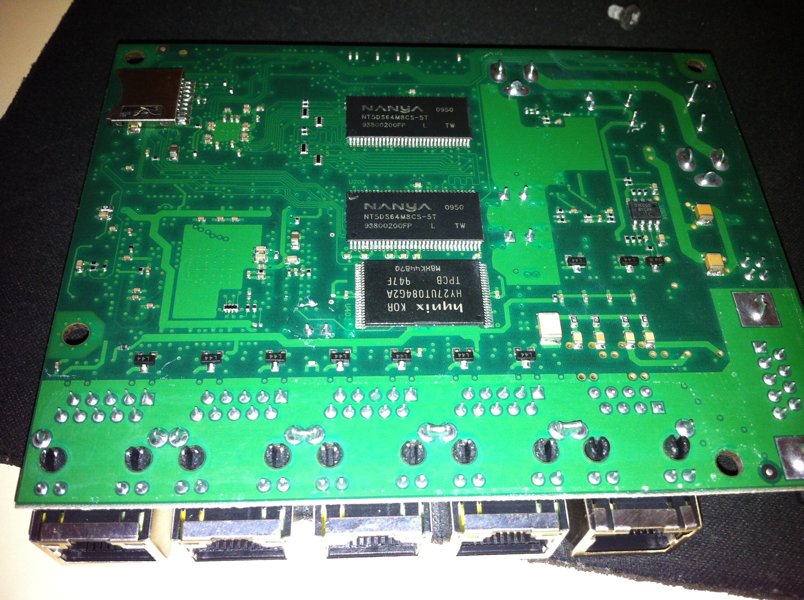

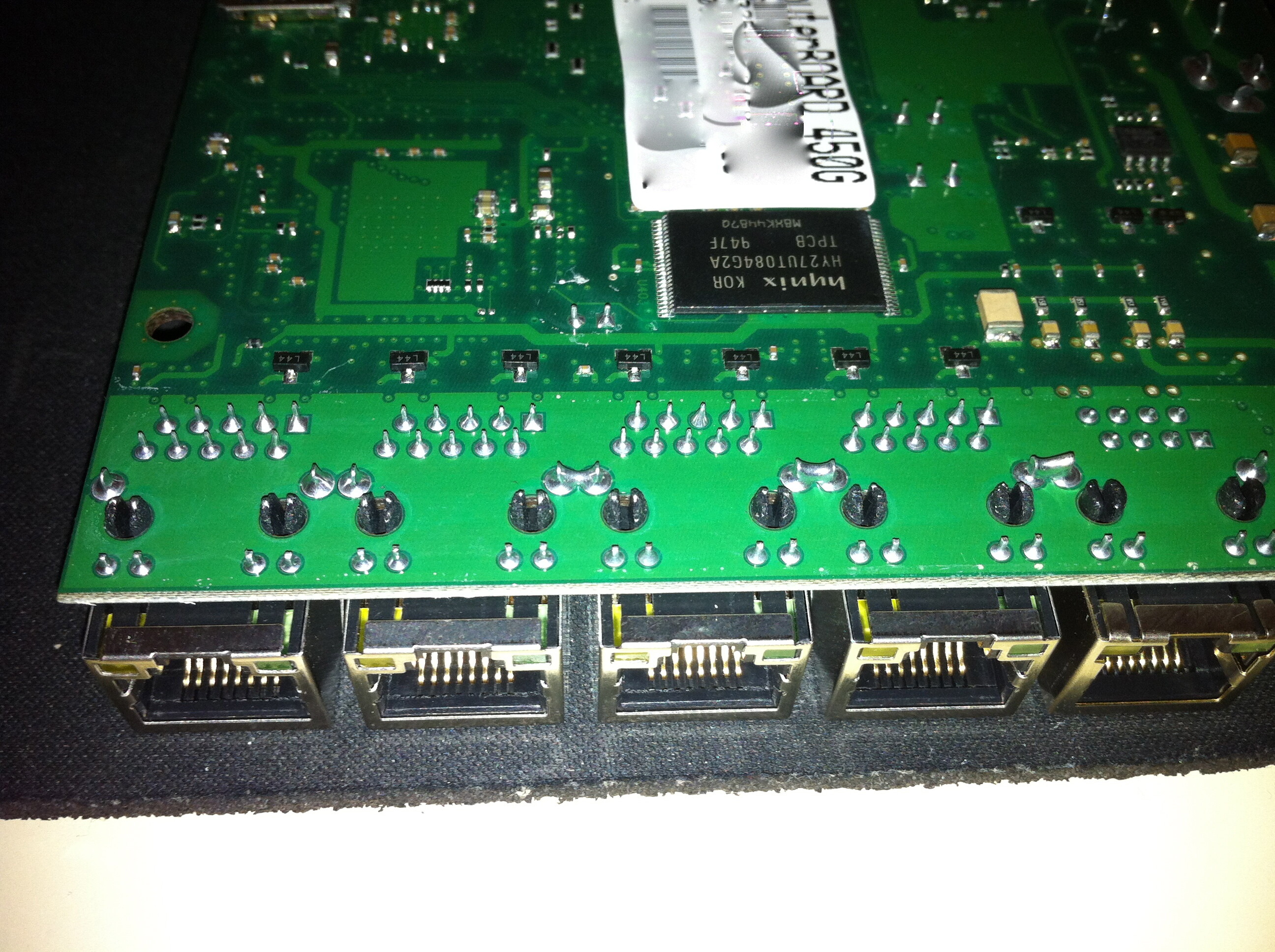

On the 450G the pin layouts are different. If I take a picture can you tell me which is the correct pins to short.
Thank you.
I try no problem
Here are the picture of the unit - Right side showing up is the PoE port
It is indeed different.

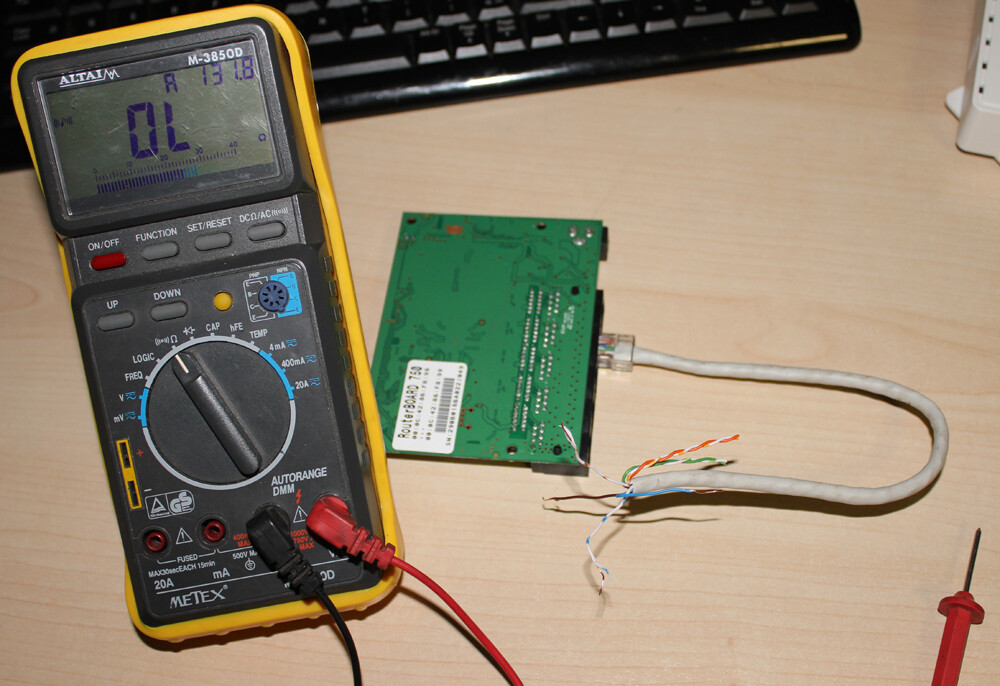

It is better to RJ45 plug at one end cut off
Dismantle the wires color code:
blue and blue-white for the +
Brown and brown white for the - pole
Measure with a multimeter the contacts like the picture shown.
Think about there is now match place in the enclosure.

POE for 10/100 Ethernet and for Gigabit Ethernet works completly different.
For 10/100 power is send over unused cables (4,5,7,8).
1000 Ethernet uses all 4 cable pairs, power is send over data lines.
Read Wiki article http://en.wikipedia.org/wiki/Power_over_Ethernet
and save your RB450G from burning ![]()
HTH,
So its not possible then?
By rewiring the ports for passive PoE, you will loose gigabit capability.
If your APs don’t support gigabit, it won’t matter.
