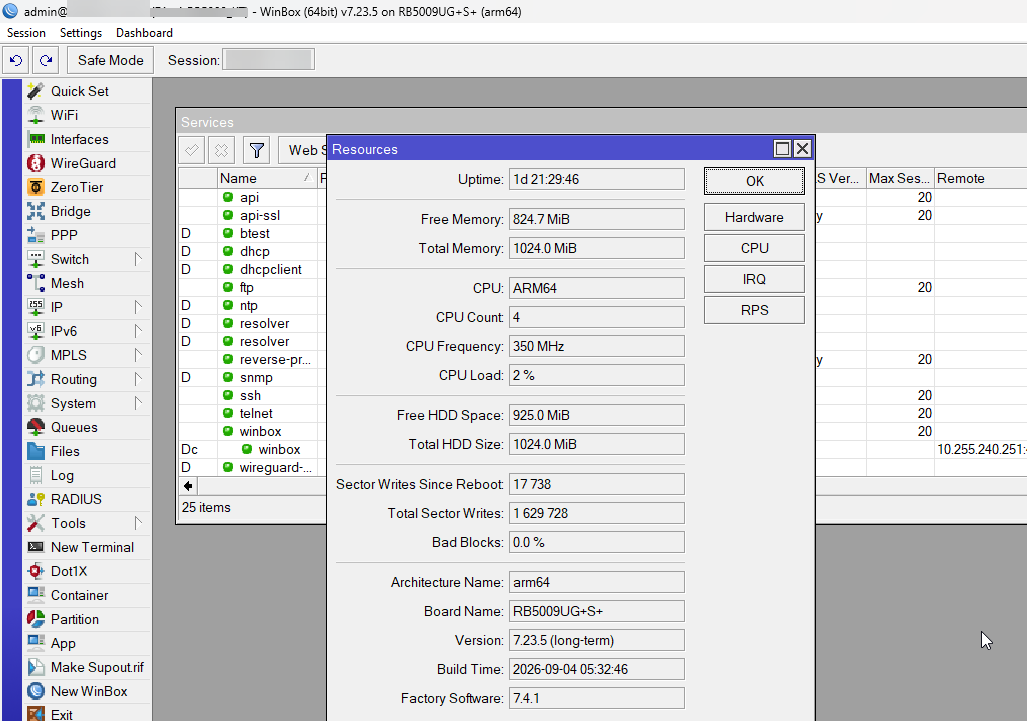

I can't reproduce your issue. On all my devices running 7.24.2 or 7.23.5, WinBox 3.43 could open the IP -> Services table without problems.

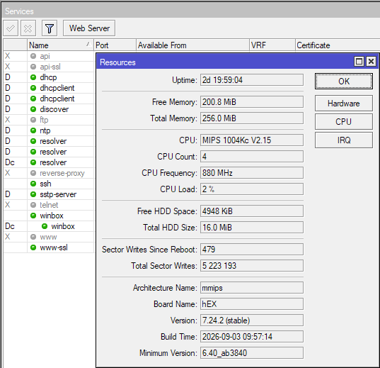

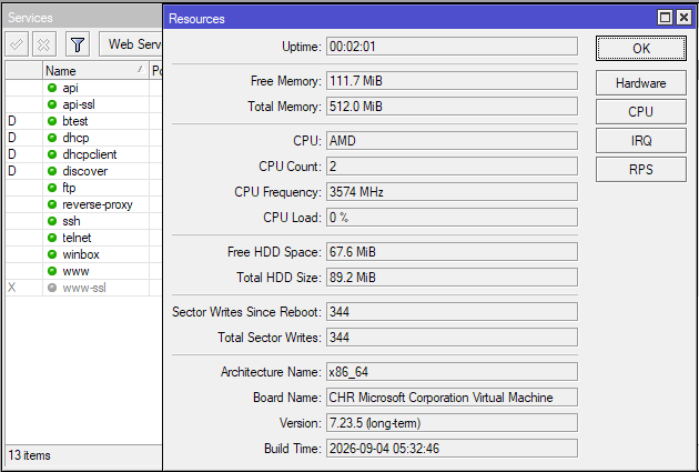

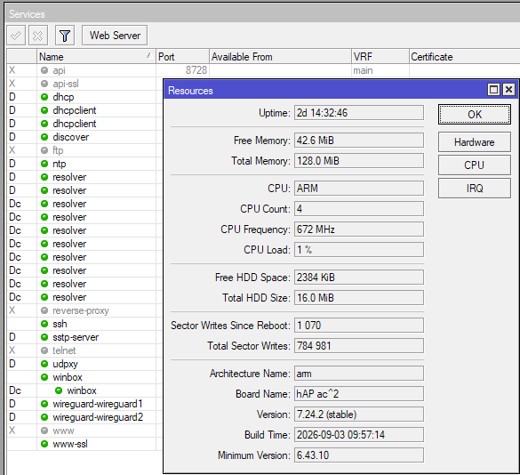

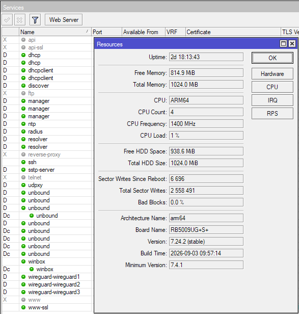

Here are some more screenshots of working IP -> Services with 7.24.2 and 7.23.5:
Screencaps

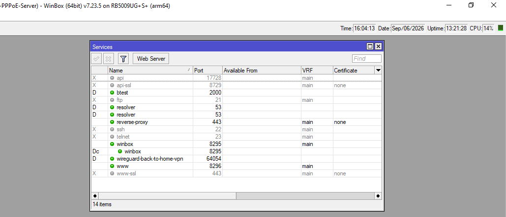

I'm not able to reproduce this bug with 64-bit WinBox 3.43 on Windows 11 and RouterOS 7.23.5 long-term.
