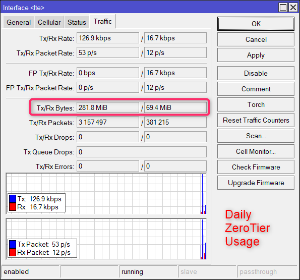

Asking as I’m burning lots of mobile data on my metered connection (hAP ax lite LTE6).
No clients connected, no traffic whatsoever, ZeroTier alone using 282MB up and 70MB down within 24 hours.
That’s ~10GB per month on a mobile (!) connection.

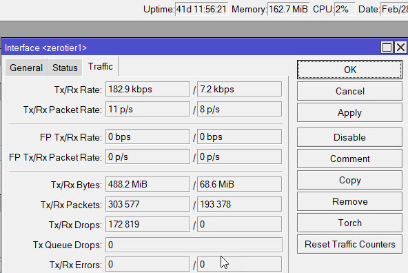

AC3 LTE, total ZT usage over 41d, give or take 0.5Gb, that translates to about 0.4Gb / month.
“zerotier1” interface’s traffic counter likely include attempts at failed paths too - so reading maybe higher from the POV of the select path.
So… generally, another one be setting (“zt1”) to only use the “WAN” interface, not the default “all”. It’s still chatty but no sense in working hard to find a paths via normal LAN/VLAN bridge.

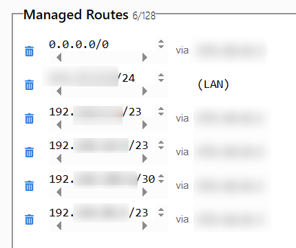

And if you use routes on the ZeroTier controller (my.zerotier.com) side & also have same routes on Mikrotik… You can easily create an ECMP route since the default ZT instance use a distance of 1, which is same a static route. And ECMP will load balance between route with same distance & be a quick way to really increase the zerotier1 counters - to check… look for any “+” next to route status in /ip/route. Changing to ZT instance (“zt1”) to a higher distance should be safe and likely desired since you’d like want a normal route used BEFORE a ZT “injected” route.
The screenshot from TeWe is LTE traffic. That’s WAN on his device, I would think ?
Mine is only ZT, including failed attempts.
A lot less. HUGE difference.
So where does the added traffic come from ?
Distance remark and routes is a good one to check, yes.
Yup, I was looking at your screenshot. :wink:

Yes correct, the screenshot is LTE interface and the only WAN interface.
No other clients connected, only ZT up and running - but also no traffic initiated by myself or other clients in ZT network.
ZT simply up and running, but still very chatty while ‘doing nothing’.
Other than that, 7.13.5 (=ZT 1.10.3) and default config (purpose: travel router via LTE for a hand full iOS clients)
What was not optimal from my side - to measure LTE interface rather than ZT interface itself (thanks holvoetn for opening my eyes).

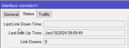

In the meantime: holvoetn, are you sure you had no link downs in those 41 days which would cause to reset traffic counters I guess?
I’m pretty sure, yes :laughing:
Amm0: 5 members in that ZT network, 2 of them other Tik’s and not many managed routes defined:
So really basic basic everything, nothing fancy at all

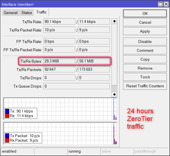

So, another 24 hours measuring - this time ZT interface directly.
~ 2,5GB per month, still very chatty but obviously ‘as designed’.
Also, as proposed by Amm0, zt1 instance set to use ‘WAN’ instead of ‘all’.
Not sure if this reduced any failure traffic counting but hey…
