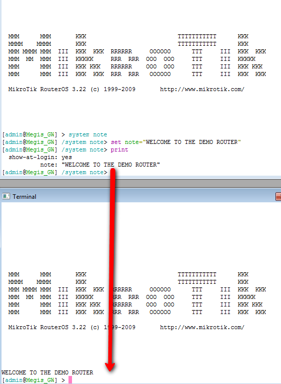

I Work in an evironment with multiple technicians who all have different levels of skills, i recently setup a mikrotik to do some policy routing and bandwidth monitoring and ip blocking ETC. ie, it is a bit more complicated than our usual setup. the problem is, everytime a different technician goes out to this client, they mess with my mik rules.
I want to know if and how i can post a message the instant someone logs on to a mikrotik using winbox, to say something arb like “please do not fiddle with these settings etc”
Thanks in advance.
Either add comments to your rules, so show others what they do (and to remind yourself), or use the Note to show at every login:
[admin@Ms_GW] > system note
[admin@Ms_GW] /system note> print
  show-at-login: yes
           note: ""

enter something in the “note” menu, and that text will always show up when somebody logs in
You can even add bigger and more complicated notes, with line breaks

please inform all of the user to click on “New Terminal” to see the message.
or will the terminal pop up itself.
true, Winbox doesn’t support these notes. You can deny access to winbox, and allow only SSH. let them learn command line :slight_smile:
