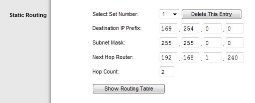

Add route to 169.254.0.0/24 via 192.168.1.253 on your 192.168.1.1 router
It will basically mean that your client behind the RB411 will get a 169.254.0.x address, the RB411 will then route traffic from this to the 192.168.1.x range, and if it is not inside this range will route it to 192.168.1.1. The 192.168.1.1 will need a route to 169.254.0.0/24 via the RB411 so it knows the return path.

added static route to 169.254.0.0 via 192.168.1.240 (see pic)
Am I on the right track?
