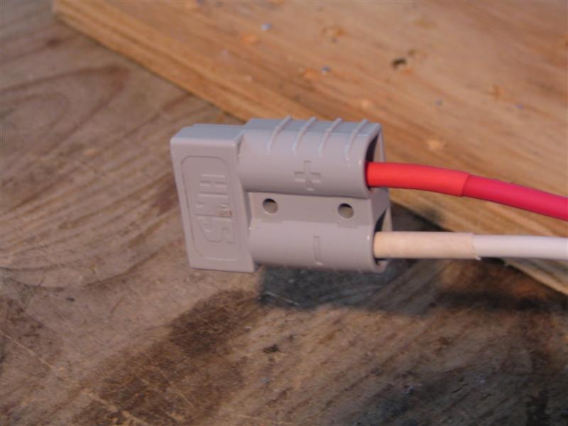

Measured under load, the voltage was 15V. Now, measured under load, the voltage is 24V. I have a DIN rail terminal block up there, so it’s easy to pop a multimeter in and take a reading.
The point of this thread is to try and work out why a 24V 4A PSU works, while a 15V 10A PSU doesn’t work on site. Yet the 15V 10A PSU works just fine on the bench.
When you have wires this thick going up a mast, you don’t worry about voltage drop.
See picture above.

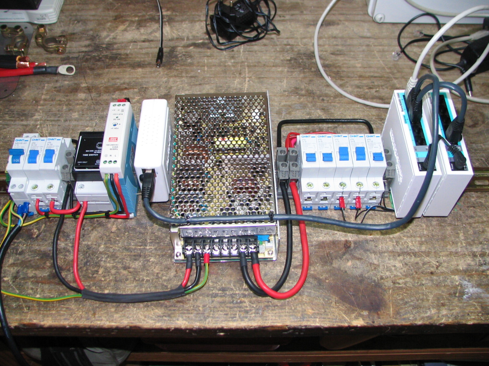

On an aside, here’s a panel I’m making up for a new site that I’m developing:
It’s currently hanging on a picture hook against a wall of my office as I’m having big problems with the construction company who are failing dismally in their attempts to waterproof the hut. I want to move in, but can’t.
The power cable, obviously goes to the wall socket.
Power goes to the main circuit breaker and then on to two more circuit breakers.
The first circuit breaker controls the blue and white Meanwell power supply.
That power supply provides power to the little Planet ATA.
The Planet ATAs are the cheapest things I’ve been able to find in this country that have IP addresses.
It’s in the “wild” so if there’s a power failure, it’ll die.
The second circuit breaker controls the timer.
The timer switches power on and off to the big Meanwell 155W “security” power supply.
I have a bank of 3 x 105AH 12V batteries that will connect to the Meanwell.
From the Meanwell, power goes to the 5 circuit breakers.
One is for the cable going up the tower.
One is for the RB250GS
One is for the RB750
Two are spare.
If power goes off, everything except for the ATA will continue to be powered. Dude will pick up that the ATA is down and we can start the process of getting power reinstated to the site, or take a generator up if it’s more serious.
The 3 x 105AH batteries should give us about 60 hours of run time for 2 x RB433, 2 x RB750, RB250GS and 6 x RocketM5. It’s a big site.
