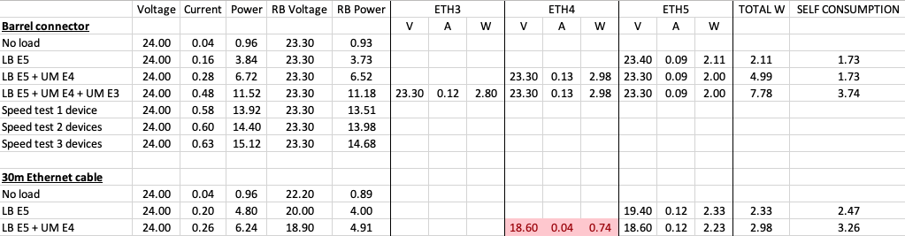

I’m testing the PowerBox for deployment on rooftops with a 30m Cat6 cable run from the 24V PoE injector into ETH1, then two UniFi Mesh APs + one LightBeam AC for backhaul, connected on ETH3 to ETH5.
Measuring while directly powered via the barrel connector over a 50cm cable, setup works fine, with a maximum load of 15W with three devices running concurrent bandwidth tests while connected to the UniFi Mesh.
If I then power over the 30m test cable, it all falls apart. The LightBeam gets powered, but the UniFis don’t get powered. Enabling the “long PoE cable” option only causes the UniFis to power up, then shut down, with lots of audible PSU hissing going on. These are the measured values (if anyone needs explanation of columns etc., shout):

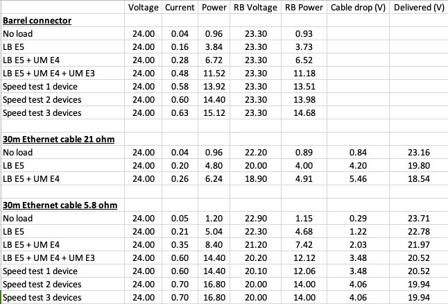

It seems suspicious to me that even without any load (0.04A is no load) you see 1.8V drop on 30m ethernet cable. And more than 5V drop at one quarter of an Amp, which would mean 19.6 Ohm resistance which is way more than Cat5 specifications require (less than 0.188 Ohm per metre or 5.64 Ohm per 30m). With maximum allowed resistance, voltage drop at full consumption (3 devices, speed test) should not be greater than 4.5V (15.12W at 19.5V equals 0.796A which, at 5.64 Ohm resistance, equals 4.488 Volt drop).
Unfortunately it seems that Cat6 ethernet cables have higher specified DC resistance (around double of that of Cat5e).
I’d say you should check your ethernet cable (possibly change it to Cat5e) and connectors, they should not drop voltage that much.

The Ubiquiti gear won’t take higher - well it might, but it may wear out the caps faster etc. This is also installed at high altitude, high heat, so not ideal to push specs.
I’ve measured the test cable I have used (factory made with assembled connectors), and it has between 18 and 21 ohms per cable, which is what you have worked out. In some websites I have seen specs for Cat6 at 23 ohm / 33m, and for Cat5e at 10 ohm / 33m.

So, new results are in, with a super-duper-wondercable ordered from Amazon (20€). Cat6, 30m, supposedly “high quality”. Measured resistance 5.8 ohms vs. 21 ohms from the grey cable. This time, the PowerBox PSU + injector keeps the three devices powered, even during the same speed tests on three devices at once (also tested with one device on one UniFi and two on the other).
With the Mikrotik PSU, voltage at the PowerBox doesn’t drop below 21.7V. I have determined the critical voltage for the UniFi Mesh devices to be 20V, anything below that and they start randomly rebooting. The LightBeam seems to hold up better.
The results below are from a bench PSU so that I could set supply voltage and measure current at the same time.
