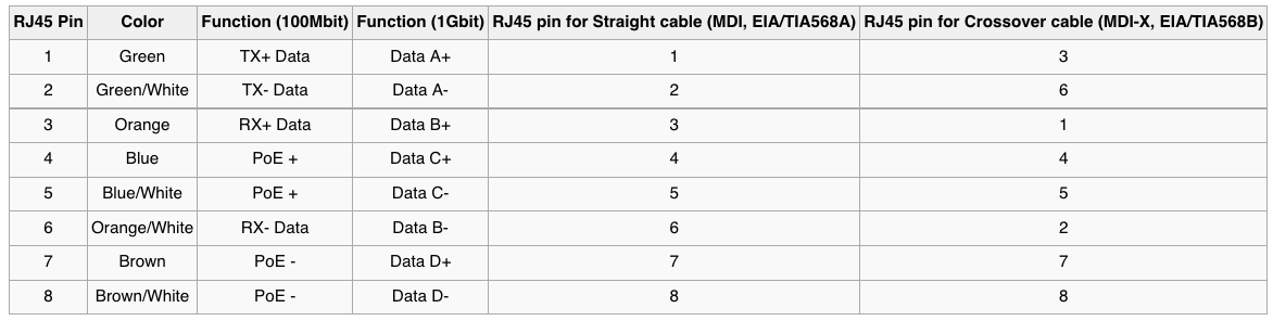

According to Mikrotik Wiki on PoE-IN:
RouterBOARD devices with “poe” labeled ports, support powering by Passive PoE over spare pairs, except where notified otherwise. This table explains Ethernet cable pinout for RouterBOARD devices, and shows powered pins for PoE on 10/100 and 10/100/1000 devices.
Note: for Gigabit models, you have to use the MikroTik Gigabit PoE injector, then > PoE is passed on pins 4,5 (+) and 7,8 (-)> . > When using other PoE injectors, power can be passed on any other pins, depending on PoE injector model> .
Text in green refers to Routerboards supporting af/at, not to 4 pair passive PoE-IN, there’s no routerboard supporting this neither for PoE-IN nor PoE-Out…
