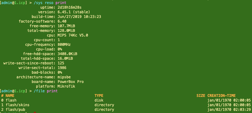

strange, mine did work well, albeit it was an upgrade from 44.3 to 45.1
also included flash usage to see how much free space you usually ought to have with a clean setup. this one has almost literally no config in it:

Well, here is mine:
[axrst@FKids0-PowerBoxPro] /system resource> print
                   uptime: 5m15s
                  version: 6.44.2 (stable)
               build-time: Apr/01/2019 12:47:57
         factory-software: 6.36
              free-memory: 107.4MiB
             total-memory: 128.0MiB
                      cpu: MIPS 74Kc V5.0
                cpu-count: 1
            cpu-frequency: 800MHz
                 cpu-load: 10%
           free-hdd-space: 80.0KiB
          total-hdd-space: 16.0MiB
  write-sect-since-reboot: 132
         write-sect-total: 193226
               bad-blocks: 0%
        architecture-name: mipsbe
               board-name: PowerBox Pro
                 platform: MikroTik
And the files:
[axrst@FKids0-PowerBoxPro] /file> print
 # NAME                                        TYPE                                              SIZE CREATION-TIME
 0 flash                                       disk                                                   jan/01/1970 03:00:07
 1 flash/skins                                 directory                                              jan/01/1970 03:00:08
 2 flash/user-manager                          directory                                              oct/03/2018 01:15:11
 3 flash/user-manager/sqldb                    file                                           80.0KiB oct/03/2018 01:22:26
 4 flash/user-manager/logsqldb                 file                                            6.0KiB oct/03/2018 01:15:14
Where did the flash space gone? Only 80KBs free. Is this (maybe) a reason for the upgrade miss-function??
