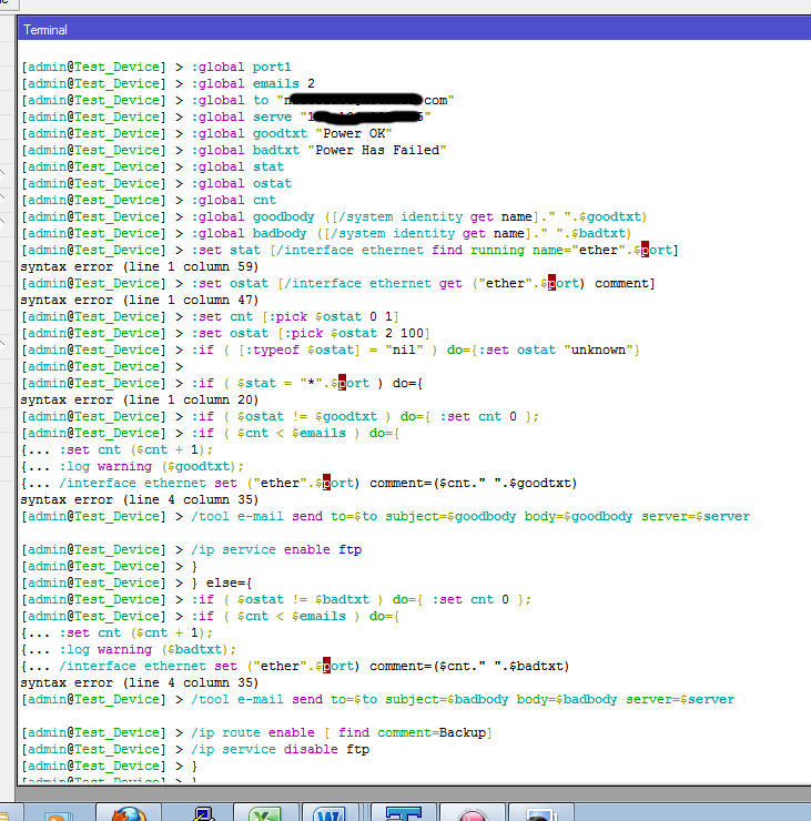

In my quest to gain some basic knowledge of scripting i tried the “For monitoring th Running State of a port, use this script, again from scheduler every once in a while. ‘port’ is 1=ether1 etc. ‘emails’ is how many emails you want it to send on a state change :-”
Changed /sys service enable ftp to /ip service enable ftp which now enables/disables ftp on ROS 5.9 but I cannot figure out the syntax errors for
:set stat [/interface ethernet find running name=“ether”.$port]
syntax error (line 1 column 59
