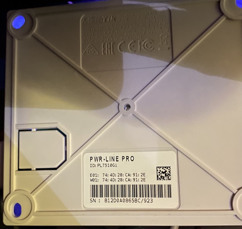

Hi!
I bought 2 used PL adapters and they work well and can connect to each other
But I do not know IP addresses (and the seller can’t help me)
I’m trying to connect using winbox, but it does not see devices. The network is flat (WiFi bridged with ether1 and ether1 is connected to PWL)
I have no ether on my laptop so can’t connect directly.
Could you please help me to get access to the devices? Are any default addresses?
One of the devices:
There are two hints on the product page that suggest that there is no IP address at all - operating system is not specified (whilst it is for other products) and flash memory size is 4 MB which is really low. So the only administration interface seems to be the sync button.
If I remember correctly that model has no user interface, all of the device control is by way of the pushbutton and PoE on/off switch. You may be able to communicate with them using the Qualcomm open-source PLC utilites, although there is no real need to.
It looks like some kind of fraud =( Yes they do not write ROS version on the page with device details but
who can expect to find an ACTIVE device made by Mikrotik but without RouterOS?
I just replaced one unmanaged bullshit made by TPLink with another one but made by Mikrotilk =(
Could not connect to the MT PL Pro. Is it only layer 2? No L3 ?
With Devolo PL there is the “Devolo Cockpit” for Windows.
For TP Link, there seems to be “tpPLC” Android APP.
I’d like to configure SNMP on devices, maybe send traps on PWL link down, but seems it is not possible
