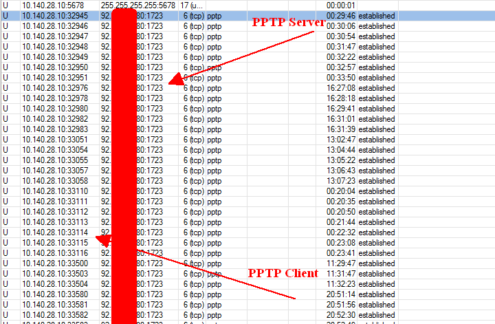

  • Site2 MT: IP > Firewall shows hundrend of connection idling
    The same time, site1 MT does not have an active PPP connection
    The screenshot is taken from Site2 MT (client)

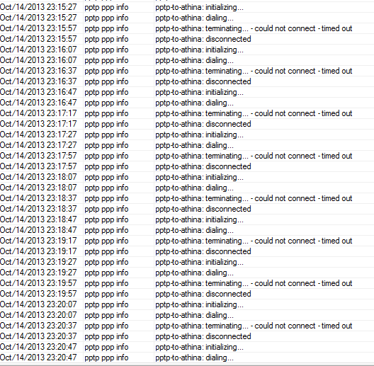

  • These are the logs from site2 MT (the client)
    While these logs are being generated, I am continiously connected to MT (through internet) from site1
    Hence there is connectivity

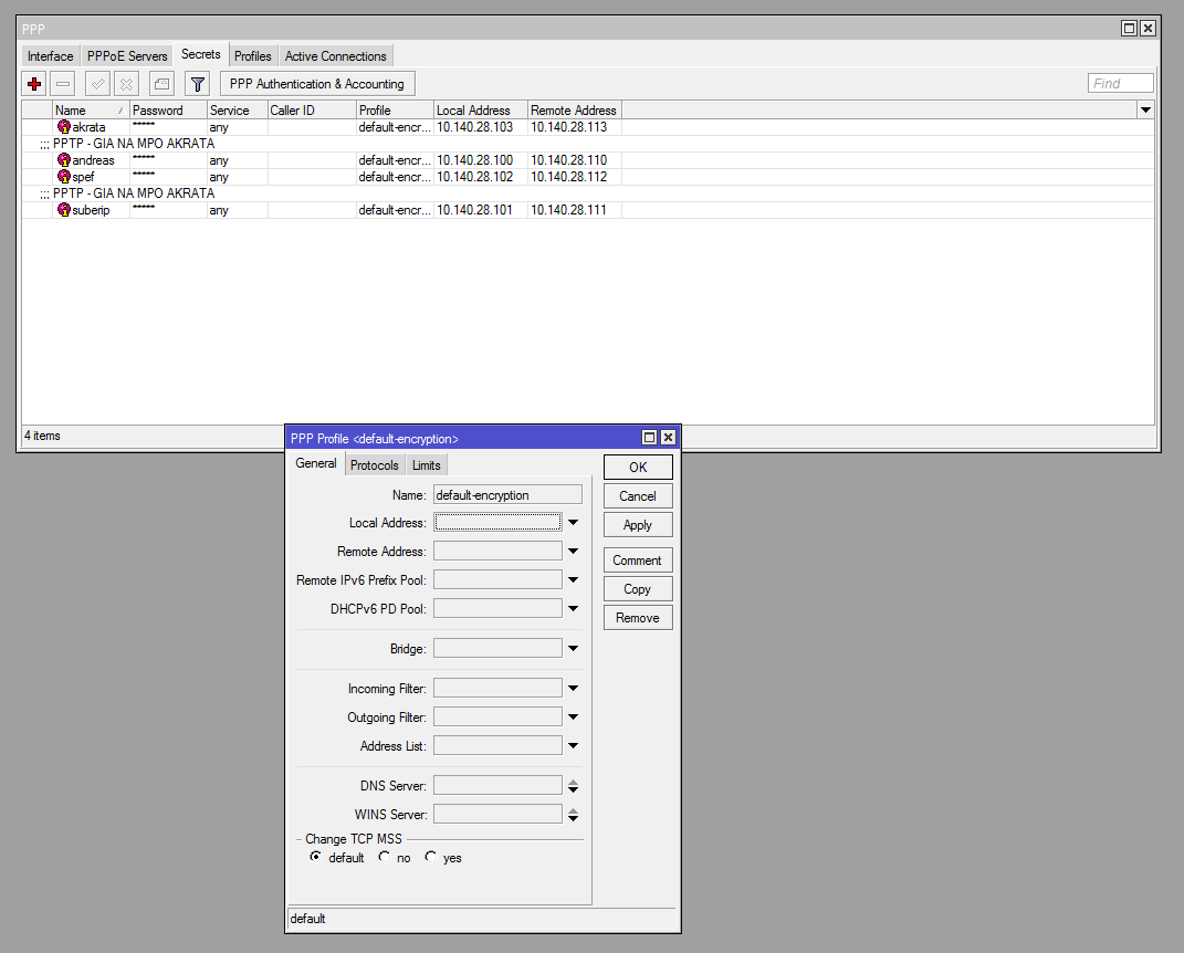

Get correct ppp profile
This is the profile used
I cant find any error…
Any ideas please?

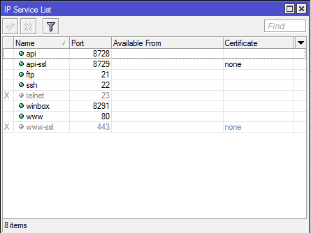

Can you ping the ip you try to connect to?
Is pptp enabled in ip firewall service port?
Use following easy profiles:
Server:
#default
/ppp profile add change-tcp-mss=yes name=ppp use-ipv6=default
#user
/ppp secret add name=xxxxxxx password=yyyyyyyy profile=ppp remote-address="the address you give to client"Client:
/ppp profile set 0 change-tcp-mss=yes use-compression=no use-encryption=required use-vj-compression=no
/interface pptp-client add allow=mschap2 connect-to=“publicip of server” disabled=no name=pptp-out1 password=yyyyyyy profile=default user=xxxxxxxxxxx
then I get:
/interface pptp-client> monitor pptp-out1
status: connected
uptime: 3m10s
encoding: MPPE128 stateless
PS, why you use different local address?

This is what I see:
I use different local address in order not to connect them directly in my LAN.
Then I can apply various rules based on their IP
