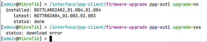

[admin@MikroTik] > /interface/ppp-client/firmware-upgrade ppp-out1 upgrade=no
  installed: BG77LAR02A02_01.004.01.004
     latest: BG77R02A04_01.003.01.003
     status: done
[admin@MikroTik] > /interface/ppp-client/firmware-upgrade ppp-out1 upgrade=yes
  status: download error
[admin@MikroTik] >
same issue….. likely picking up the wrong firmware but check marking as upgradable?
status: done
