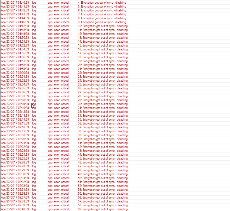

ppp,error,critical Encryption got out of sync - disabling
Hello
Mikrotik CCR1036-12G-4S
Package 6.38.5 lastest version
https://routerboard.com/CCR1036-12G-4S
any solutions?
