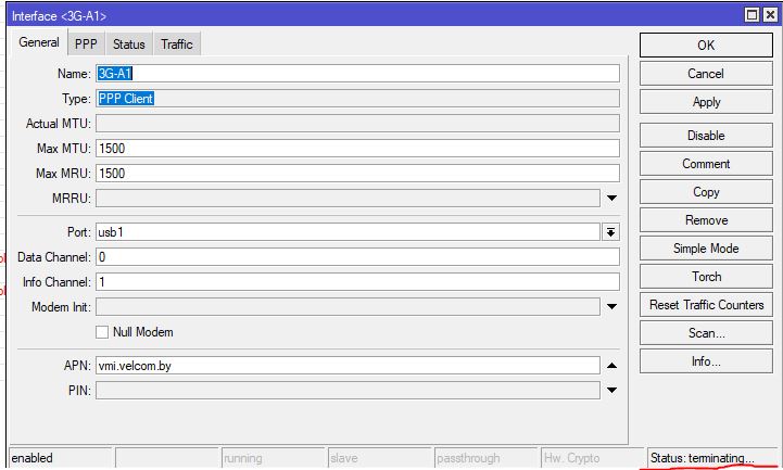

PPP (LTE\3G) Client doesn't work on any router with os 7.X on huawei e3372 stick
I’ve moved on ROS7 again, and PPP is not working on any router that I tesed: HAP AC3, Mikrotik hAP ac lite and RB2011UIAS-RM - os 7.X version with huawei e3372 stick it just wont connet.
On ROS 6 (Tested on diferent versions: some old and latest one and on HAP AC3, Mikrotik hAP ac lite, RB2011UIAS-RM) - everething is working fine…

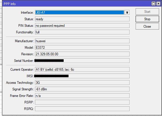

Info is working fine btw

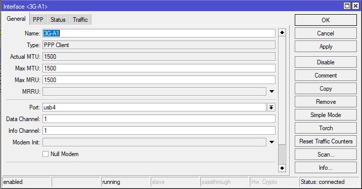

Solved, thanks to Artis Bernāts from support@mikrotik.com for helping with that.
The 3g modem e3372h-153 with STICK firmware - sometimes on ROS 7 it sends wrong PPP chanel settings and thats why its not working.
By the these commands i’ve tried manually found the working channel:
/system serial-terminal usb1 channel=0
And for second channel
 /system serial-terminal usb1 channel=1
Checked what modem responds by sending the following commands using serial terminal
        ate1
        ati
        at+cpin?
        at+cfun?
        at+cgdcont?
        at+cgact?
        atd*99#
The last command will trigger ppp connection should return “CONNECT”.
So i figured out that everything is working on 1 channel only not on both 0 and 1.
