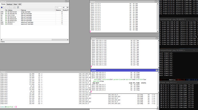

Having a little bit of an issue. Cisco got damaged and had to replace it with RB2011 laying around. My issue I’m having is that I have to connect to office network via L2TP.
My main internet WAN connection is via PPPoE. Up to the Mikrotik, everything works and I can ping local ranges at the office etc.
Issue I’m having is my client device such as my workstation and other client device cannot see these ranges or ping. See picture attached of what I mean.
Assistance will be appreciated.

I’ve added the config. The 192.168.0.0/24 range randomly started working on client devices such as 192.168.0.102 in the office. The 192.168.80.0/24 ranges till not reachable by client devices. I’m using the default config and firewall of MT for now. Let me know what else you require.

I fixed the “ether2” issue. Thank you for noticing. Yeah, I can ping the main router over in the one NDC on 80.1.
I can even open the NMS on 80.3 without an issue but cannot ping it. The 80 range is a VSAT 550ms+ range. Still don’t explain it.
The other ranges just started pinging and became accessible randomly without intervention half an hour after creating this post.
Sniffer also get response from 80.3

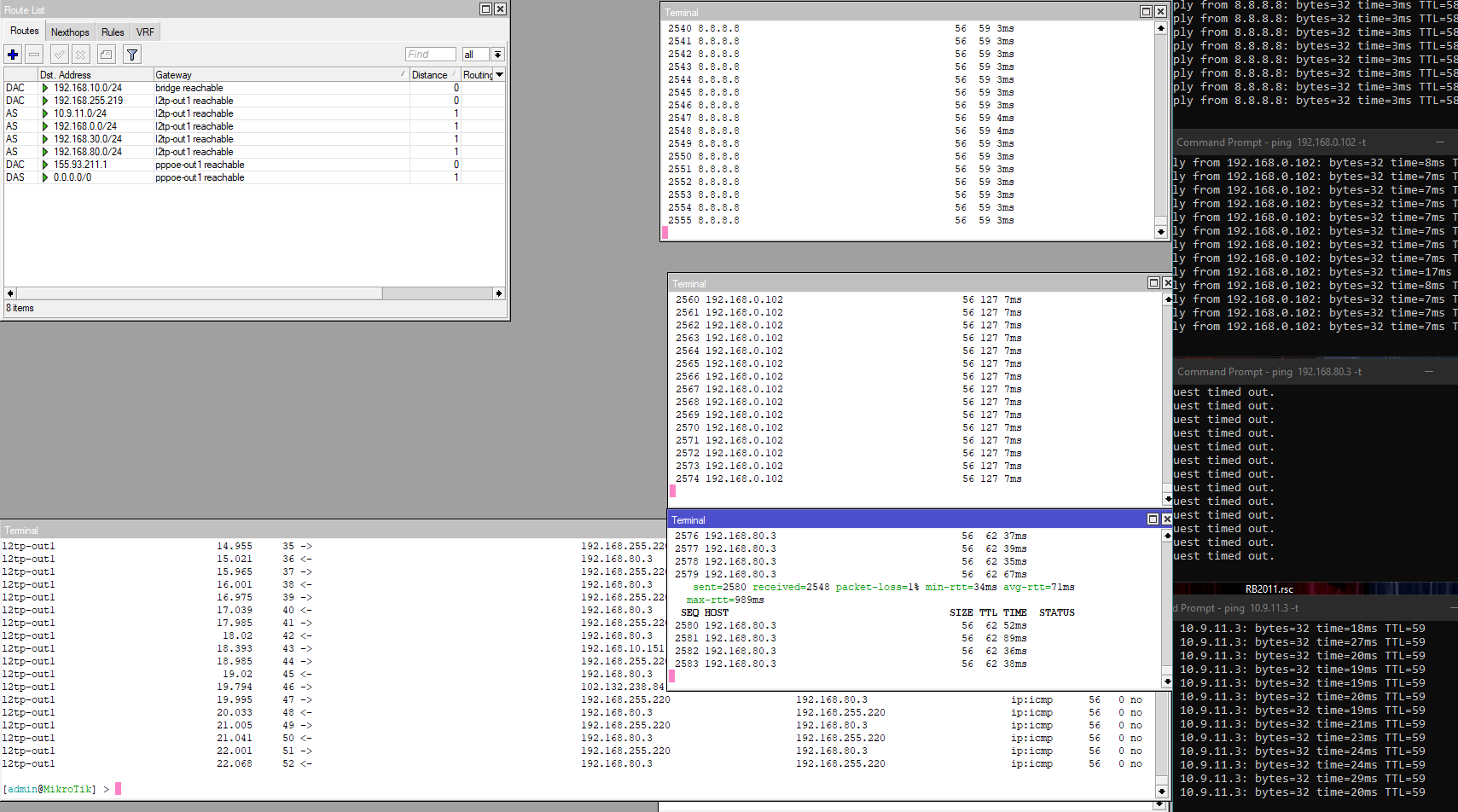

Do I read you right that the sniffer shows an ICMP response from the 80.3 but the client cannot see it? I.e. the response doesn’t make it through the Mikrotik to the client?

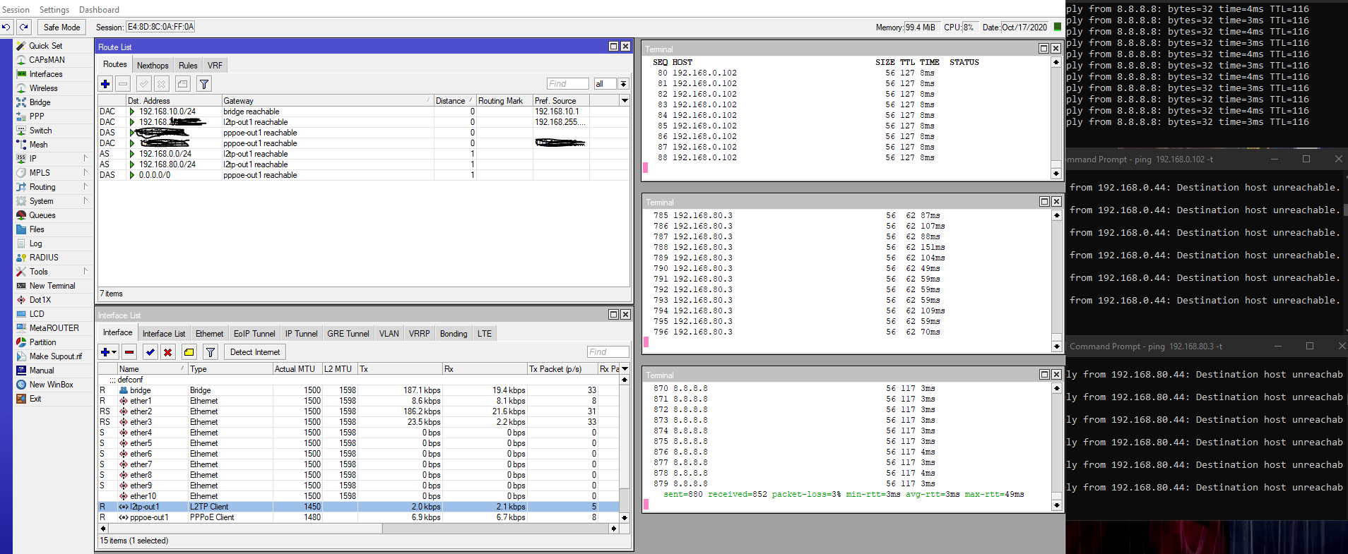

Yeah you did read that right. I know you don’t like screenshots, but see attached. To the right is the client pc that can’t ping it but can access the NMS. The screenshot also shows the response of the sniffer.
Aaaaand there it started pinging randomly without intervention…
Am I missing something about Mikrotik’s dynamic process’?
The sniffer says the response from the 80.3 arrives 40-60 ms after the request is sent in the opposite direction. But as you mention there’s a VSAT link in the path, 40-60 ms is mission impossible, so could it actually be 1040-1060 ms (i.e. response to request N arriving after request N+1)? In that case, pinging from the Windows with -w 1500 might give better results?
Everything works great now. However, did found something Saturday evening after a lot of reading that caused this “anomaly” even though I was a bit skeptical about it, it seem though that it was the route table cache in the background. Did test it yesterday quite a bit by disabling “route-cache” and all routes establish instantly but then losing the fast path functionality and when enabling it as it is on default, it “hangs” the route for a time again before responding. Can’t say for sure that this was the issue.
