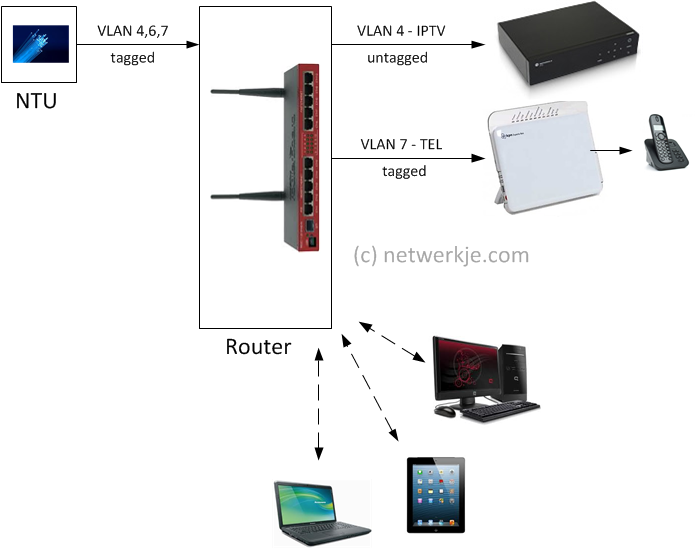

I’m new to routeros, and it’s a weird story how I got it. But my problem is that PPPOE can’t connect. I need to use VLAN6 for internet, 4 for TV and 7 for the telephone. I think i set it up correctly but the problem is probably in the vlans.. I hope someone can help me

At the moment I can’t connect to the router because I’m at work, so I will do that later today. And yes, I will attach an image of how it works. They don’t show vlan 6 on an ethernet port but that is used for internet. The white box (called an experiabox) is the old router, but I need to keep it because it’s used for the telephone over vlan 7.
