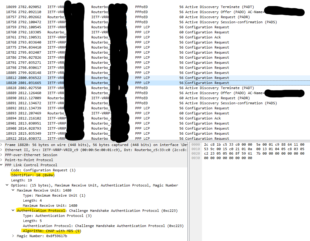

If you use a snnifer on the ether1 interface you get this
After 10 request the ISP server gives up and sent a PADT

BRAS is repeatedly sending Configuration Request to Mikrotik,
but no answer from them.
