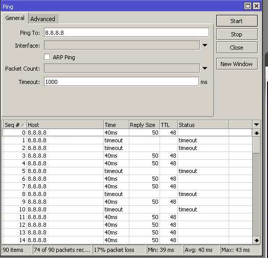

I have RB951G-2HnD. My ISP uses PPPoE. I can see big packet loss on that link (see screenshot). No matter what address I try to ping, no matter what physical port I use, no matter what firmware (5.23 and 6.2) I use - losses are there. I tried to change MTU and MRU on PPPoE link from 1480 (default on Mikrotik) to 1492 (default on my old ASUS WL500g) - same losses. I don’t have any losses when I ping router from my computer.

I have the same issue:
RB951G-2HnD
RouterOS 6.19
ISP: Rostelecom (Russia)
Packet loss when connecting to my ISP via PPPoE.
Ping 8.8.8.8 and ya.ru have lost packets. Numerous sites don’t opens.
I’ve changed MTU an flow control of Ethernet interface and nothing helps.
When connecting via PPPoE to ISP from two other devices (laptop and home server) everything fine.
And if I place Dlink DGS-1005d between mikrotik and ISP - mikrotik connects without packet loss.
How to fix this PPPoE issue? What configs I need to show?
