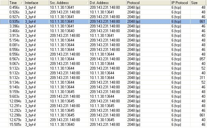

Version 2.9.48. I can see that some packets are going out to the server to port 80 and coming back. The trouble is that the communication will stop after a while how you can see in attachment
