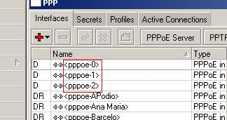

Hello guys, ussualy I see in pppoe active connection pppoe-0 pppoe-1 pppoe-2 pppoe-3 etc, etc at the same time, these connections are clients trying to login, but they cant do it. Wireless registrations are OK, not bad strenght, good ccq. pppoeserver problems? the configuration is the same in the RouterOS Manual.
