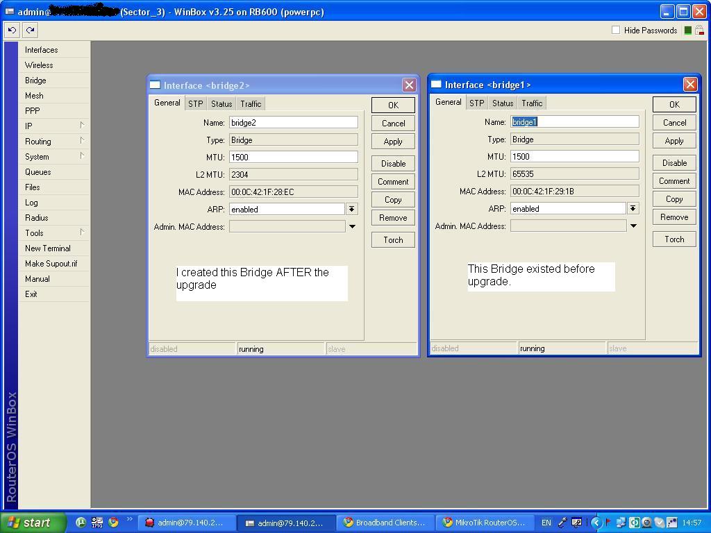

I suggest that you create a new bridge in 3.25 and put the PPPoe onto this new bridge and see if that fixes the problem.

They have introduced a new L2MTU into the bridge and wireless interface screens and this is probably what is happening.
